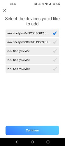

I’m having problem with connect my new Shelly TRVs to my homey pro.
I got one connecting yesterday without any problems. But today i can’t get the 2 other ones in. I have tried resetter both TRVs and my homey with no luck.
It seems like they connect because they calibrate but the tile doesn’t show up.
Also i get 3 other random ā€œShelly devicesā€ when i they and connect them. It’s seems like it’s a copy of the ones shown with IP.
I hope for a fix soon so my summer doesn’t get any hotter.
Thanks in advance
I see the issue, this is caused when a Shelly device has an empty device name in the settings. I’ll see if I can fix that with the next release. For now you can solve it by adding a device name in the official Shelly app or through the webinterface.
I can not reproduce this, pairing my Shelly TRV works fine. Have you tried rebooting the TRV and pairing it within the next 3 minutes? And could you send me a diagnostic report after trying to pair it.
Do you have any special network configuration resulting in ghost devices being identified over mDNS?
Hmm, i had no problems yesterday.
Well the connect screen have changes since the last update 2 hours ago with the extra one (ghosts).

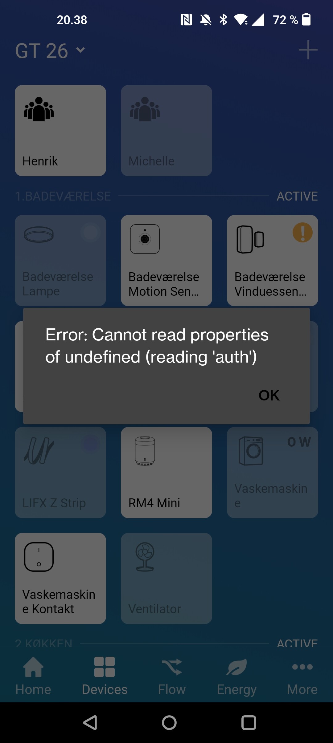

There is nothing in the log you send me. That error seems to indicate that Homey cant reach the TRV during pairing though when trying to determine if it requires authentication. Make sure the TRV is awake and have good network connectivity.
Had the exact same error as you on multiple devices:
Error: Cannot read properties of undefined (reading ā€˜auth’)
After going to the web interface and enabling ā€œDevice discoverableā€ in the settings (for those devices that have the option, like the 2.5, rgbw2) i was able to add the first one just fine (will now try the rest of them). May just be random, but I guess it’s worth a try. Also, be aware that in the web interface (at least for me) there’s a small bug. If you enable Device Discoverable and reload, you will see it’s not enabled. For me what works is expanding Eco Mode (just below it, for a 2.5) and disable Eco mode, enable Device Discoverable, reenable Eco mode. I’m guessing it’s not a dependency, but some sort of js web interface bug (didn’t spend time investigating).
Don’t know if @Phuturist can work around it, I’m guessing it’s possible.
Anyway, very happy with the new release, will report back on any issues once I finish adding the rest of my devices…
Edit:
Plus 1PM doesn’t have a Device discoverable setting, so these… I cannot add, I get a slightly different message (device is on 0.11.0-beta3)
Error: Cannot read properties of undefined (reading ā€˜auth_en’)
So, after posting this:
I fiddled with the settings more and I discovered that one of my +1PM managed to succeed with the adding process. After looking at the differences between the one that successfully connected and the one with the error above, I discovered that on the one with succes I had the ā€œOutbound socketā€ setting enabled and connected, reading ws://LOCAL_IP_OF_HOMEY:6113/ and SSL Connectivity set to *
I have no idea when I did that or if it somehow set itself, but after replicating this setting, it now connected just fine to Homey.
Hope this is useful to someone.
That is unrelated. These settings are added during pairing by my app. The error Error: Cannot read properties of undefined (reading ā€˜auth_en’) is earlier in the pairing process. As mentioned before, this is somehow related to networking issues. It would also explain why you can sometimes pair the devices and sometimes run into this error. Rebooting Homey might help.
