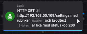

The rest of the guide all was OK, even when I tried to do HTTP GET request to the UNI.
And it is working from the Shelly Iphone App and from webinterface. Hmm I am out of ides for now…

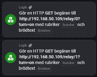

It is possible so activate both relays with a HTTP GET request and that is working.
It is a good work around but not perfect.

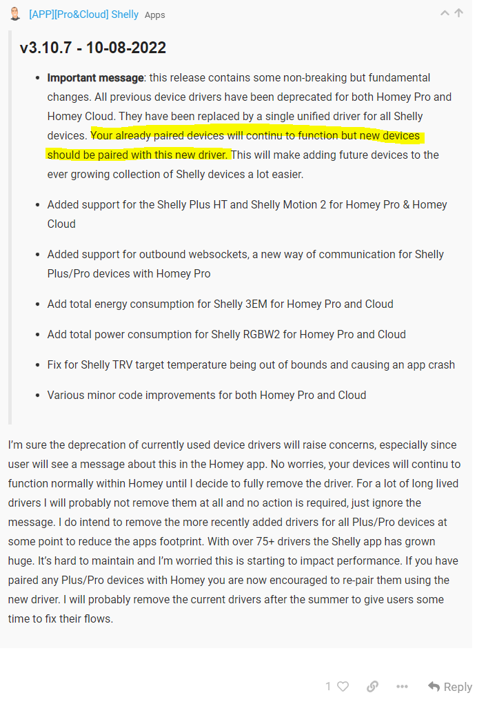

I have started to get a message, every time I tap on my Shelly product in Homey:
“This device type might not be supported in the future”
What does it mean and why am I getting this notification now?
Just paste that message into the search bar…
It means you haven’t read the change log and did not even try to find out yourself before coming here.
That is not the case. I have read the changelog, but this part is confusing:
How do you choose which driver to pair the devices with?
That’s a totally different question as your first one but ok. There is only one driver left so you do not need to choose anymore. The app will make sure it install the correct device based on your selection in the pairing wizard.
