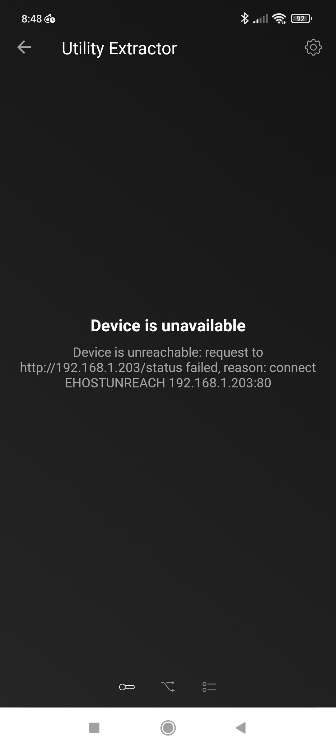

I’m having a bunch of issues with Shelly last 24 hours
I’ve restarted the app, restarted homey and still got devices dropping
It’s not holistic tho and I see no rhyme or reason for it. The devices that are working / not working all work fine from the Shelly app and all have the correct IP addresses as shown
 Any ideas?
The error indicates a network issues. Homey can’t reach the Shelly device. Possible reasons:
  • Homey has bad wifi connection
  • Shelly has bad wifi connection
  • Your WiFi is not stable
  • There is interference
  • Homeys network stack is unstable
Perhaps start with rebooting your router.
But this cannot be the case. I have 6 Shelly devices, 4 of them are working absolutely fine
    o if this were the case 4 would not work
    o if this were the case neither the 4 would work, or all 6 wouldn’t work via the shelly app
    o it’s stable
 everything else is working seamlessly
    o nothing has been introduced to cause interference and it’s been fine for 12months?
    o I’m not sure on this, but given other devices are working I can’t see how this could be
Try replacing the Homey power adapter.
Wifi is sometimes less stable, because channels are changed and maybe conflict with a new device or neighbour.
Please do let me know what the case is when you find out.
The Shelly devices state that wifi is good, and homey WiFi is working for yeelight (and other Shelly devices)
The error is a network error in Homey for these two devices only, but it makes no sense since Shelly app can control then
@Phuturist never going to know
 I’ve done all testing I can, so they’re either broken or they’ll randomly start working again for no good reason!
And the devices have a static IP address which matches the one in Homey?
As last resort you can try re-adding them.
Yes, both static (shown in screenshot that they match above)
I’ll try re-adding I guess, they don’t appear without removing tho so need to check which flows I’m going to need to fix first
