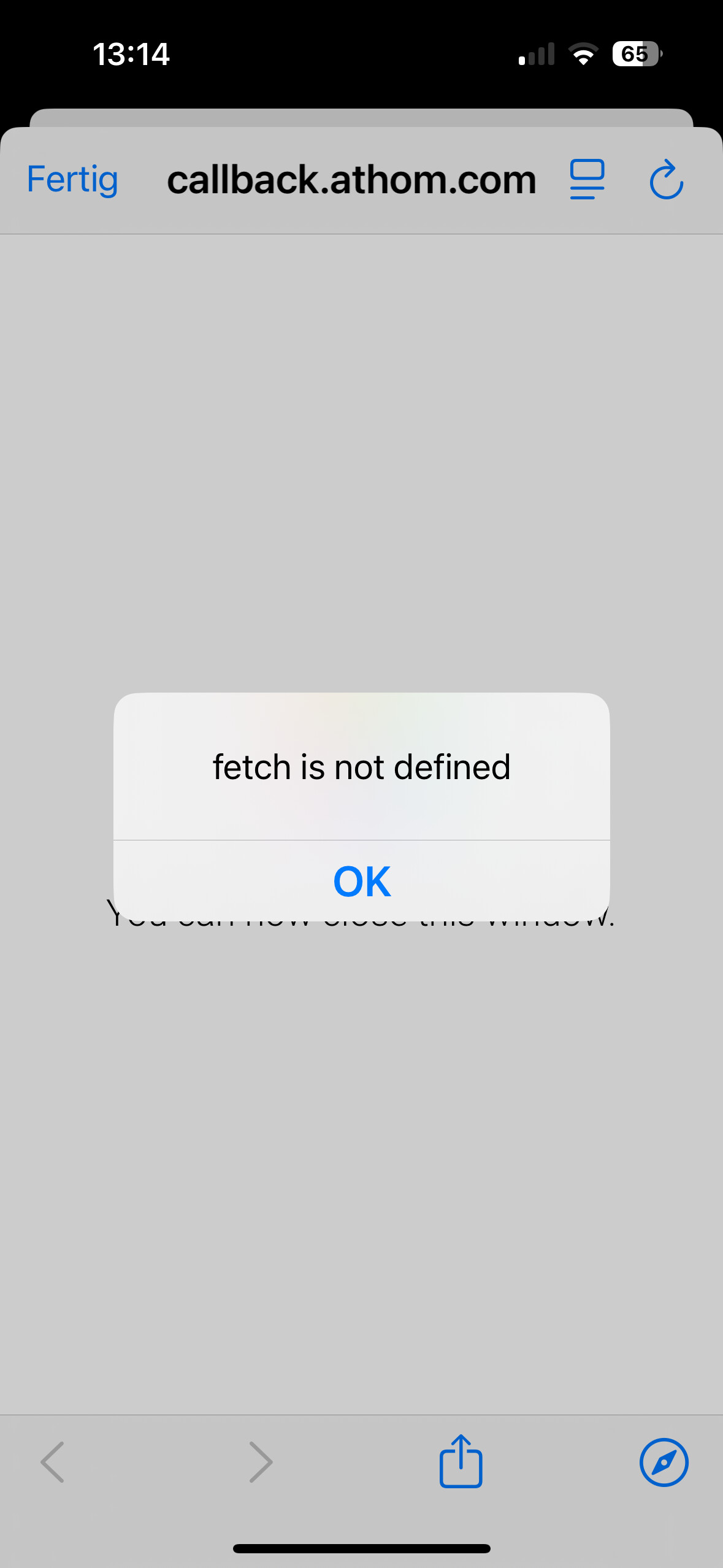

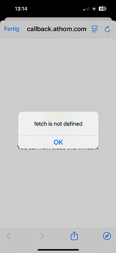

I tryed it 3 Times but allways received the following message
Are you on a HP2019 maybe?
No, Homey App Cloud
Mmh. I think I know why. Homey Cloud uses a very old Node version. Will try to implement a workaround in the next version. Thx for reporting!
