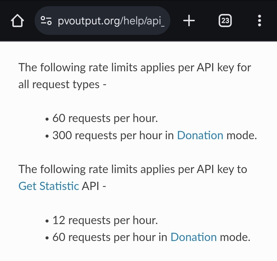

Robin, When I’m right, atm there’s a 2 minute minimum interval; just fyi: it seems sending data is allowed with a 1 minute minimum interval, only fetching data has a 5 minute minimum interval.
But I believe it adds to the total of 60 calls per hour. And uploading more then once per 5 minutes doesnt help, since the server only stores data on 5 minute interval. At least that is what I understand from reading the api documentation.
