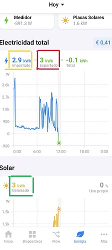

Hello everyone.
I installed the new app via the API, but I don’t think it’s collecting the data correctly. Here are my values ​​for today.
Homey
ShinePhone
The Imported Energy (yellow) and Exported Energy (red) data are incorrect.
The Generated Energy (green) value also doesn’t seem right.
Is this an error? Or am I misunderstanding the data?
Thanks in advance.
