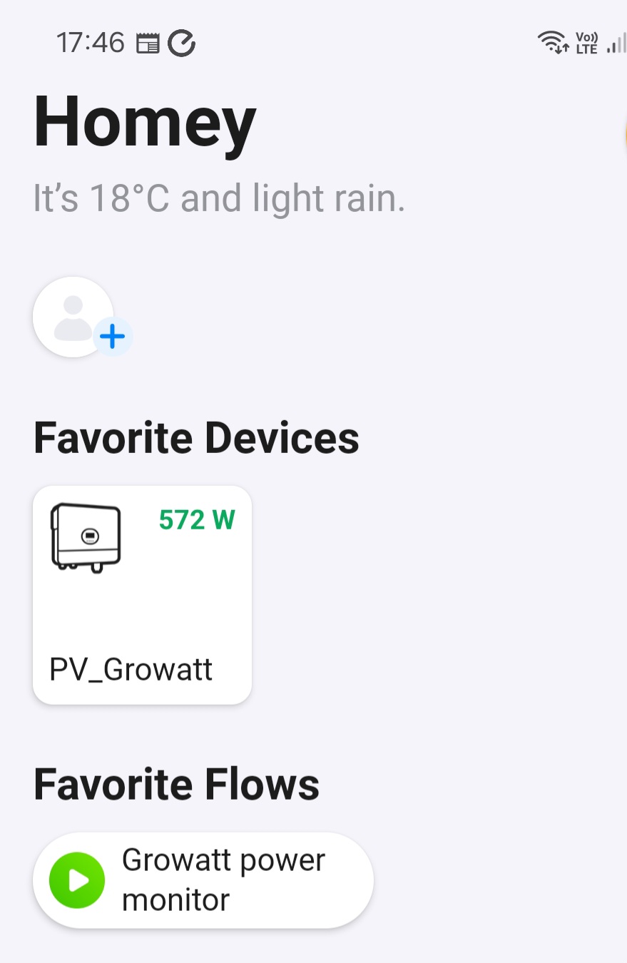

Here some screenshots of my problem (other images will follow in reply, i can add only one at the time)
  • Red mark signals problem with my Growatt (timeout message)
  • In engery tab no data from PV system
  • When opening PV device it indicates ‘device not available’
  • But, when opening Insights, i can see all the data…
  • Same on app and web app
I hope this helps with the troubleshooting
Strangely, sometimes the error disappears by itself (sadly only for a short while)
I tried again just now and i am logged in :grinning_face:
Just tested on the local wifi at home. Not sure if this makes a difference
