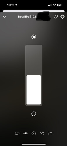

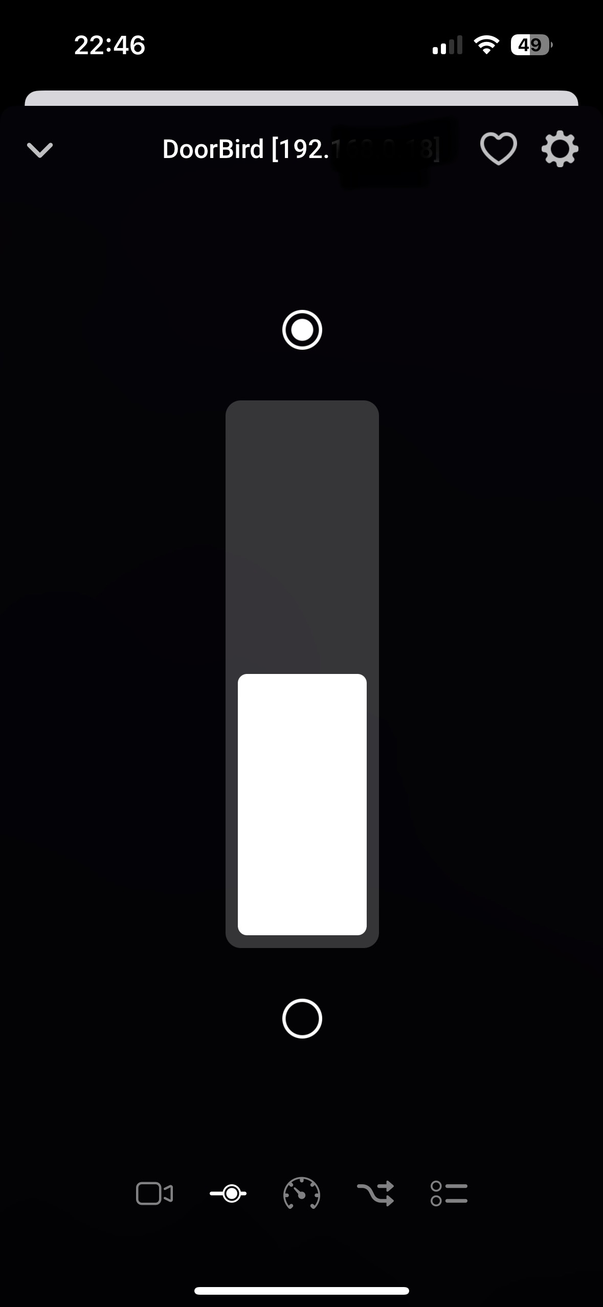

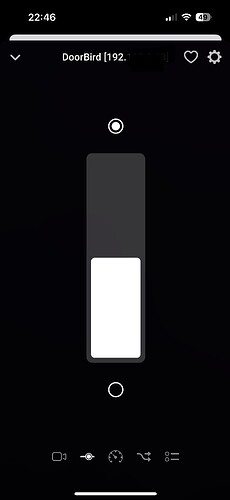

Could you check if you can see the snapshots from the web UI. It looks like there is a bug in the Homey smartphone app where you can not select any of the other snapshots.
In the web UI I can see the various (all 3) snapshots, but not in the IOS app, only the live snapshot.
I can neither see nor select the relays in the web UI or in the IOS app. I only see relay 1.
So, that is a bug in the Homey smartphone app and not for me to fix.
I just pushed a fix for this to the app store. You will need to re-pair your DoorBird for the relays to become visible.
