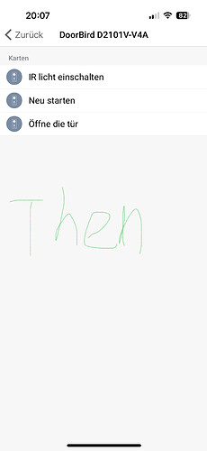

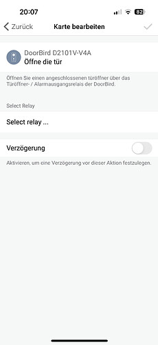

Please read what I’m asking you. I’m not asking about the relays under the device but when using the action card “Open the door” from when adding it to a flow.
I‘m very sorry! I‘m not sure if i understand it right, but i try:

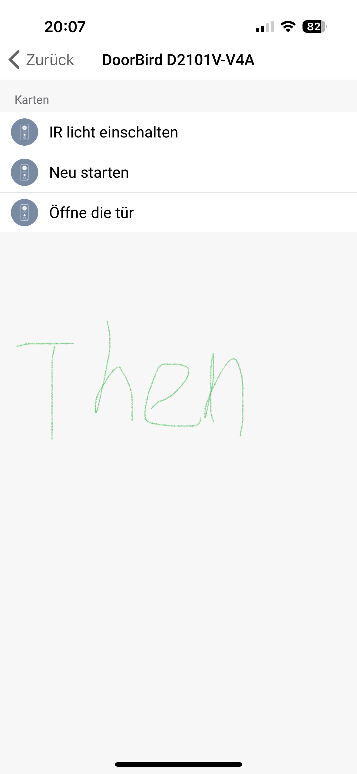

I get these options by when:
I get these options by then:

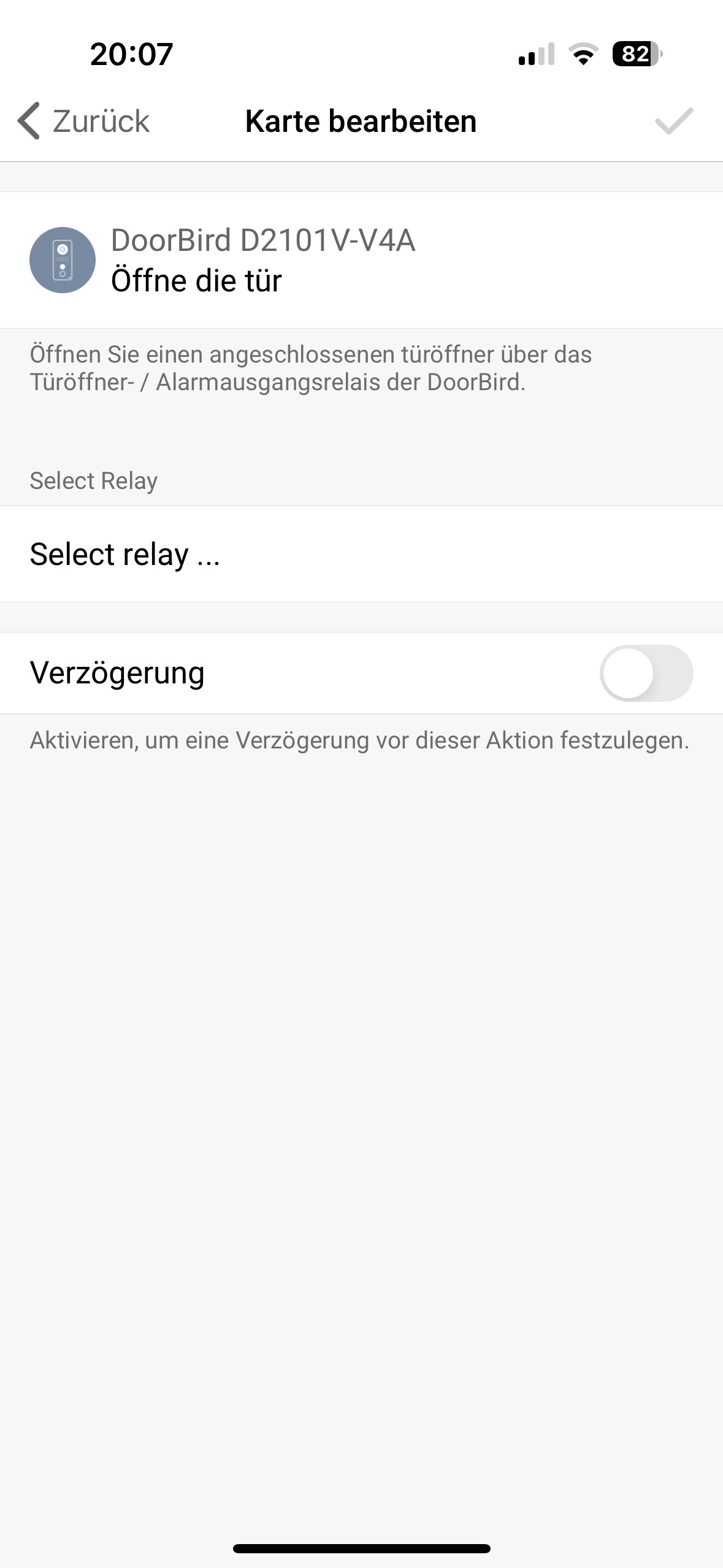

And if i take „öffne die tür“ (open the door) i get the option o the 2 standard relaiys:
Von Michel Brönnimann’s iPhone gesendet
Did you add the door controller after you paired your DoorBird with Homey? Could be you need to re-pair the DoorBird to show the extra relays under the “Open the door” action card.
Hi, i repaired my doorbird now, but nothing changed, i just have teh two standard relays in the action card.

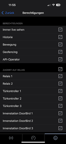

About the relays of the door controller. Have you checked that the user you used to pair the DoorBird has permission to access and control these relays?

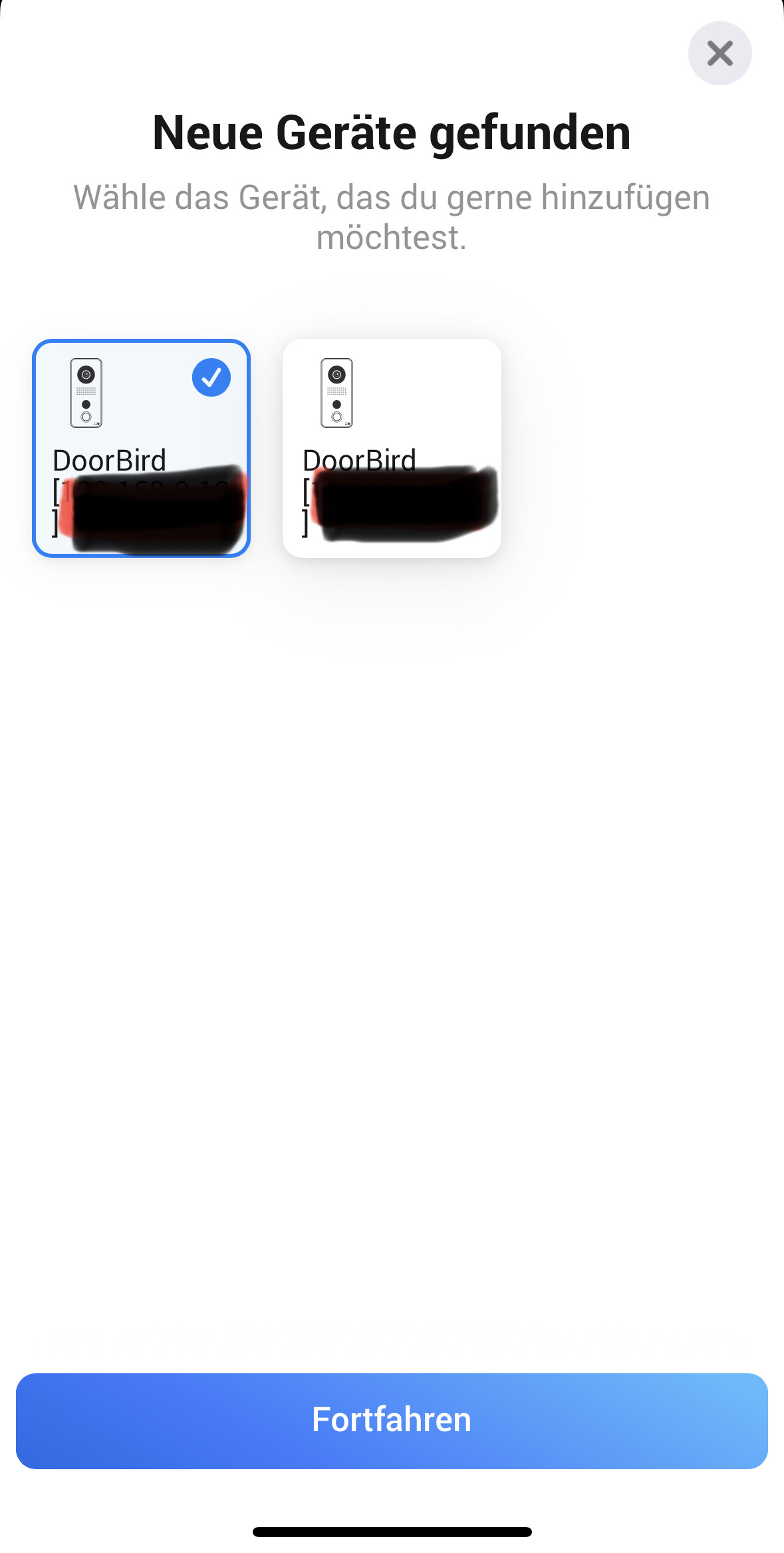

Hello
I Have a Homey Pro 2023 and i have a Doorbird external station, indoor station and a door controller.
The external station i could pair with homey, but the indoor station and the door controller not.

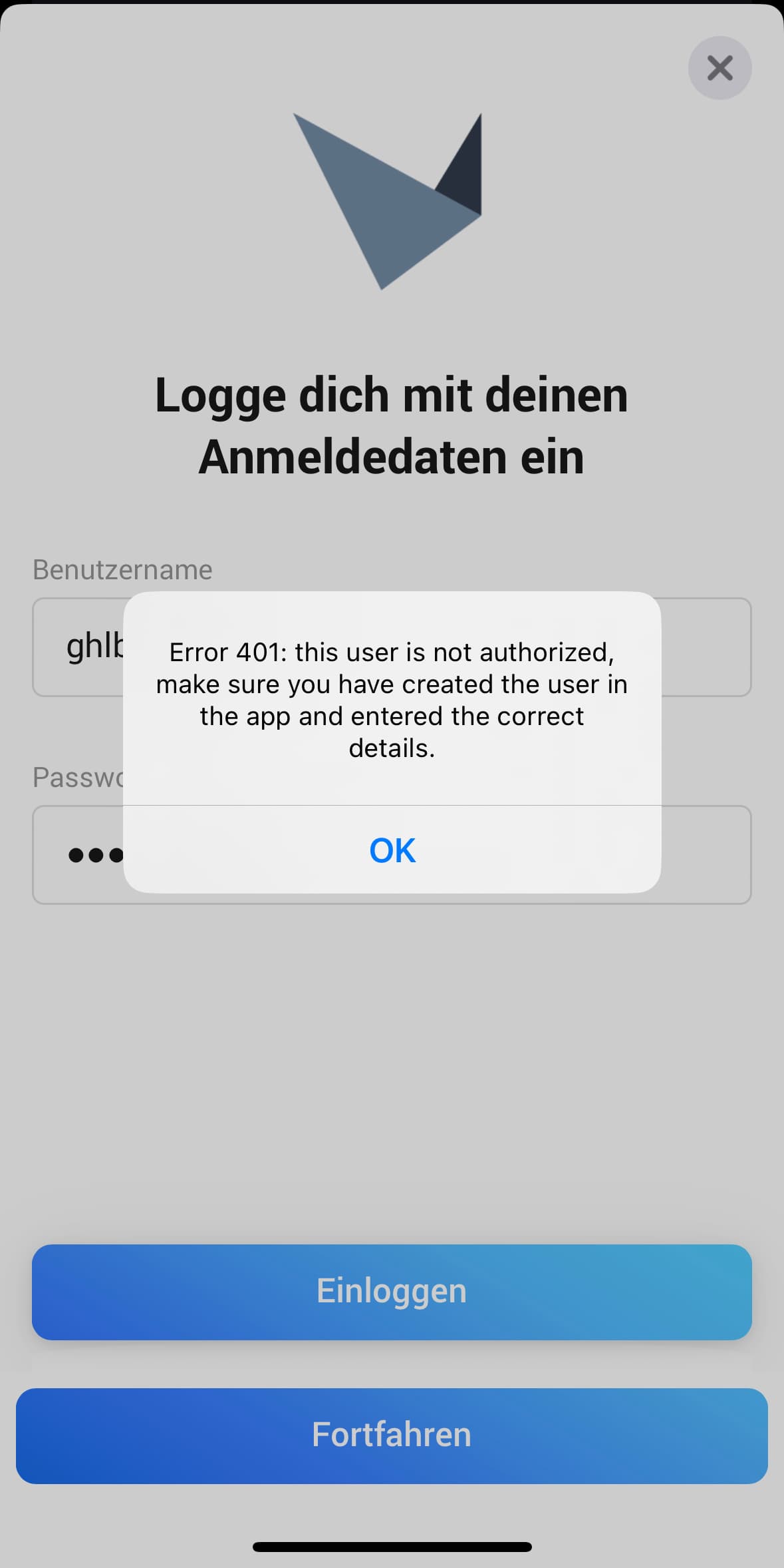

I created a user for homey and with this i could pair the external station, but when i use this for the other two devices, it dont work, i get the following error. I can see them, but not pair it. What can i do?
Thank you very much
The error suggests there is something wrong with the permission of this user for these devices. You should look into that.
Why can I pair the outdoor station and not the other two devices? I use the same login data.
I pasted the login data several times by copying it. But I also entered them several times by hand. I have also deleted and recreated the user several times, I can always pair the outdoor station, but the other two devices always get the same error message!

I think both devices have no support for 3rd party control using the LAN-2-LAN API as far as I can tell. Even if they would pair with Homey, you would not be able to do anything with the devices themself. It would be better to filter these devices in the pairing wizard but as I do not have these devices I would not know how.

Ahh ok, then it is not possible to pair these two devices! I thought since they are showing it should be possible. I hoped to get the missing relays from the door controller and not just via the “then” action card. I now have the relays in the action card, but the possible uses are relatively limited. For example, I cannot select the relays directly either. For example, I can only give an open command, but not a close command, which is a pity. Do you plan to integrate this?

Also, I can’t retrieve the last doorbell snapshot or the last motion sensor snapshot. What could be the reason for this? I can only get the Live Snapshot. The same applies to the two standard relays, I can only select the first relay, but not the second. Could the cause be the app or maybe Homey Pro 2023, what do you think?

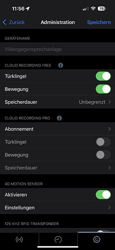

Sound like you have not enabled Cloud Recording (Free) from the DoorBird Administation or havent given the users that was used to add the DoorBird the “History” permission.

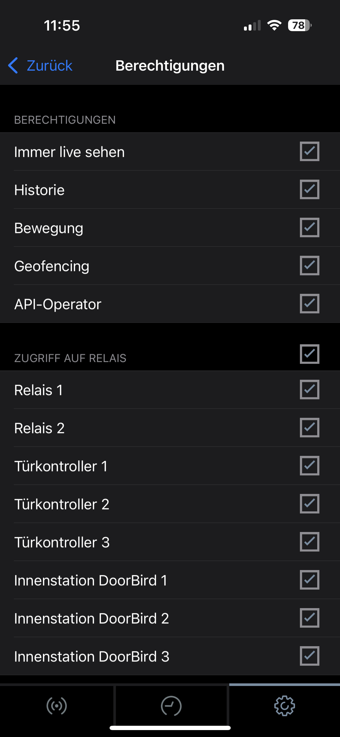

Then I created a user with ALL rights for Homey Pro. Then I paired the door station with Homey. Then I wanted to pair the indoor station and the door controller with Homey, but according to your information that is not possible.
I can only select the standard relay 1 in the Homey app, but not the second, is not available for selection.
In the THEN action card I can select all relays. So the user has the rights and access to the relays, but it probably won’t be displayed correctly!?

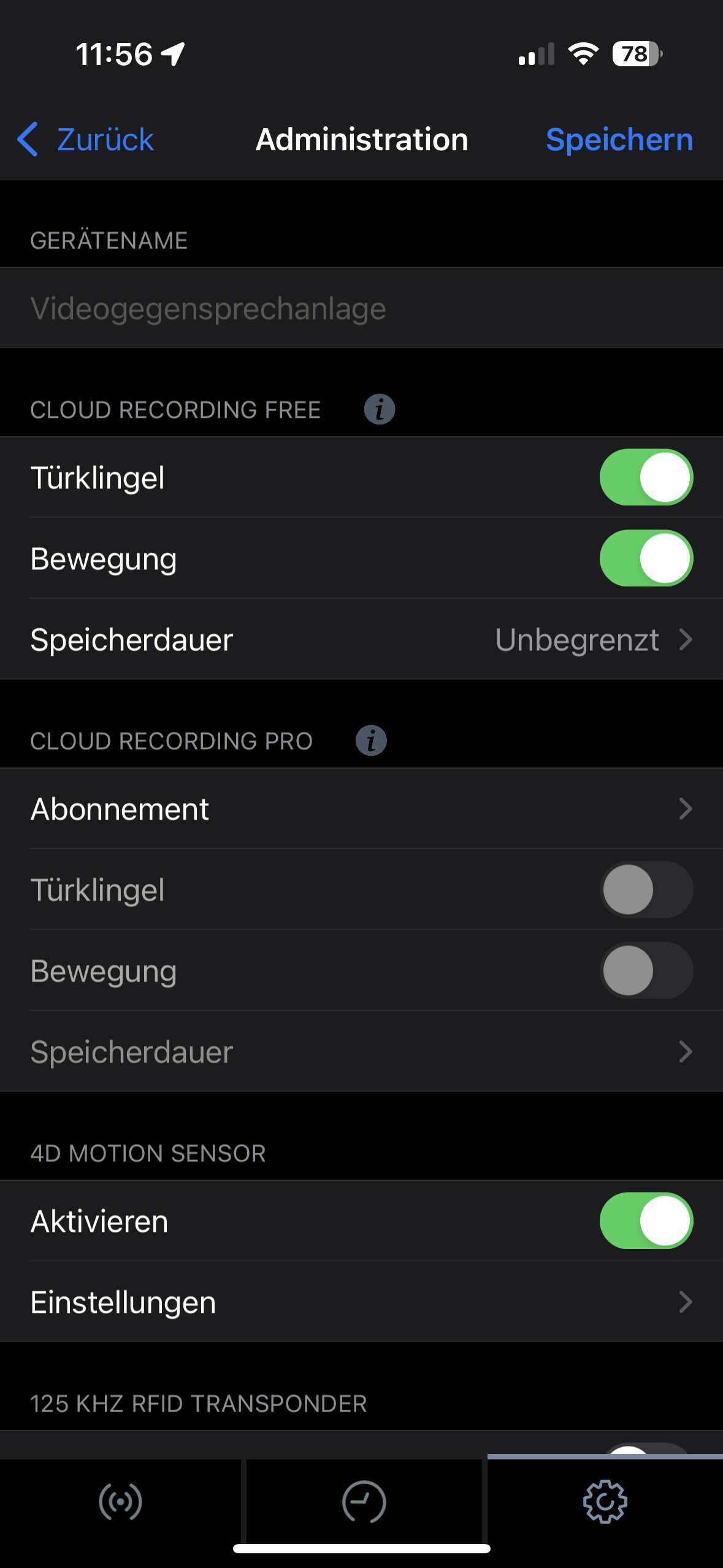

Yes, I have Cloud Recording and I own ALL the rights.
As you can see (see point 1), I have all relays, including the two standard relays 1 and 2.
As I said before, I would appreciate it if you could take a look at my installation via Team Viewer. I probably have a small error somewhere which I can’t find. Because according to your information it should work, I’ve done and checked everything, but can’t find anything.
