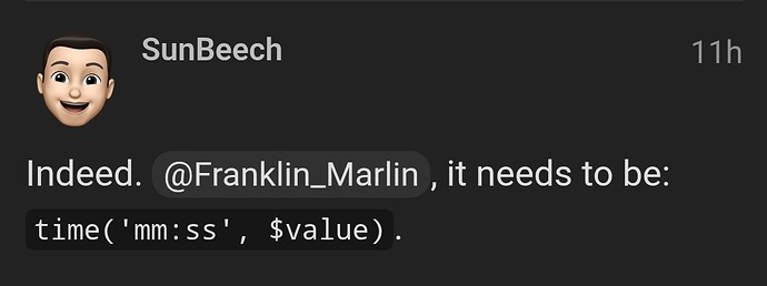

Your image is to blurry for me to see, but i hope you copied the text from SunBeech?
Because you need to whats the quotes, it needs to be the right qoute: '
Yes when the rimer is running, I don’t see the timer counting of the AVD tile itself
I did copied the text from SunBeech

Just for everyone’s info, @SunBeech posted it the right way by the way, with straight quotes and formatted as code:
Yes, I copied from Mr. SunBeech with straight quotes and formatted as code. But for me the AVD does not shows the remaining time. Tomorrow I will start over, and try again.
