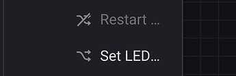

  3. Flows can be silently disabled by Homey, because of an unknown condition ‘too many triggers in x seconds’
    AFAIK only by looking at the flow status, you can find out:

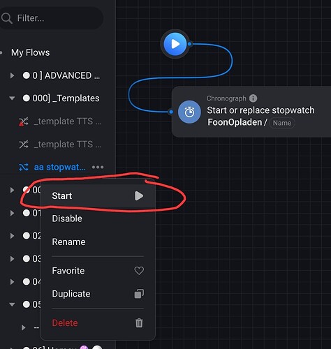

I am getting an error when I try and start/replace a stopwatch. The last time I had this issue I just changed the name of the stopwatch and that fixed the problem. Here is a screen shot.
What is the best solutions to prevent this from happening and how do I fix this issue in this flow?

I just tried it again and before throwing the error the app reports no active stopwatches. After the error the stopwatch show 00.00
When it’s a new stopwatch, you’ll have to enter the name in the field “Pick” instead, and select the entered name afterwards. After you saved the flow, the stopwatch has been created and should be functional.
I just tried that several times and there is no difference. It still throws an error.
This is what I see in the app.
If I click resume the stopwatch starts right up.
Odd… it works fine in Test mode here.
I think it might be a browser cache issue…
Clear cache, and force refresh the web page. And / or try running the web app in a private tab, to start ‘clean’.
Does it run in normal mode (non-test mode)?
Like this:
I created a new private window in Firefox. This stopwatch starts when a relay turns on so I turned on the relay and it generates the same error, no change. I tried it again starting it from the flow and it also fails.
I restarted my Homey Pro and it still generates the same error.
You can install the app again, without removing it prior to that.
I can’t think of anything else atm.
Thank you for your assistance. Reinstalling didn’t change anything. sorry Your app is fabulous, except for this crazy issue. So much better than anything else I could find for Homey Pro and especially much better than anything on Hubitat!
YW! @Arie_J_Godschalk is the app wizard :wink: maybe there’s a pointer in the app logs.
No, you do not need to do that.
You could either use the pick filed and then you need to save before use it, or just use the name field. Using the name field has the “disadvantage” that you need to remember the exact name of the timer/stopwatch/transition, as the pick field will do that for you.
