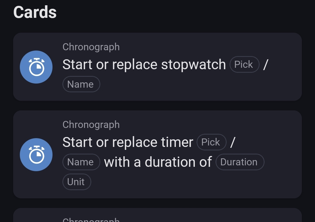

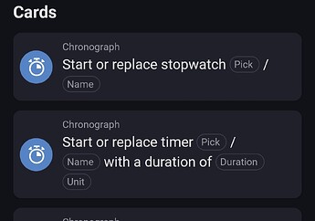

Hi Arie, thanks for this great app. I have been using it for quite some time. Since today, I get an error “invalid time” when starting / replacing some of my stop watches in specific flows. If I change the name of the stop watch it might work for a short time, but then the error comes back. Restarting the app, restarting homey did not solve the problem.
grafik
Any ideas?

But why does that flowcard not show a timefield to enter time?
Stopwatch != Timer, Arie :wink:
Hahha oeps
