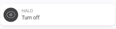

Unfortunately, I’m no longer able to turn off my HALO via Homey if it’s charging when I try to turn it off. I can still turn it off if it’s not charging. I’m using the “Turn off” flow card.
I can still turn it on without any issues.

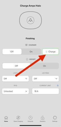

I noticed that Charge Amps has made some changes in their iOS app. There’s now a button labeled “Charge.” Perhaps this change is related to the issue?
In Homey, I have ChargeAmps version 3.0.2.
Is anyone else experiencing the same issue and possibly found a solution?
HALO Turn OFF
ChargeAmpsiOS
@Simon_Valkaer
Hi Simon, thanks for the report.
This is as you write most likely related to changes that ChargeAmps have implemented. Unfortunately I can´t see it in my setup and investigate, mine IOS App still looks the same as before the change, probably based on what version of software you have in the HALO.
But I will look into this and see if I can find a workaround/solution

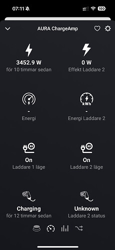

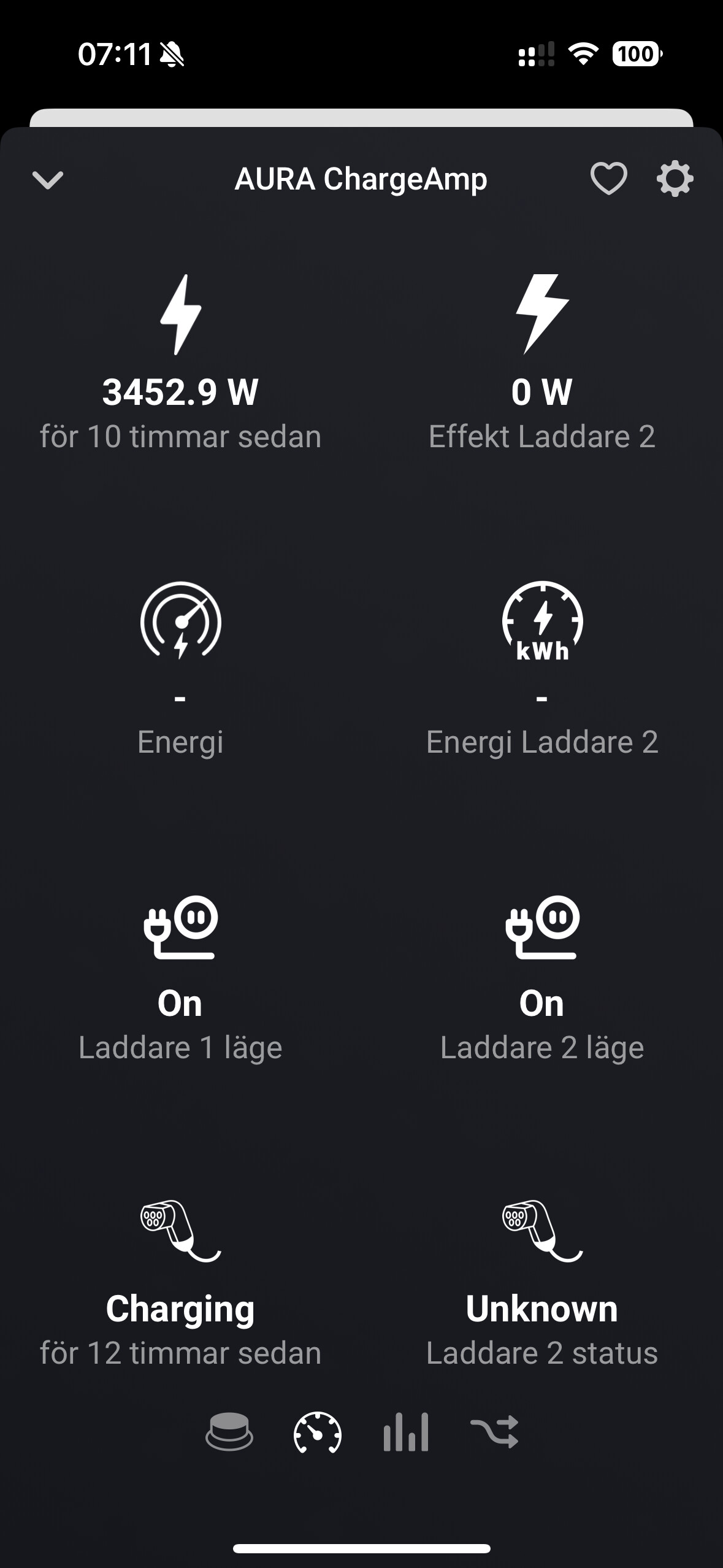

Have installed your ChargeAmps app for my Aura charger and Homey says its charging with 700W long after charging on connectorId 2 have stopped. Checking the endpoint ‘chargepoints/:chargePointId/status’ returns:
“connectorStatuses”: [
“connectorId”: 1,
“totalConsumptionKwh”: 12.147000312805176,
“sessionType”: “ThreePhase”,
“status”: “SuspendedEV”,
“measurements”: null,
“startTime”: “2024-08-22T05:57:47”,
“endTime”: null,
“sessionId”: 79076427
“connectorId”: 2,
“totalConsumptionKwh”: 0.0,
“sessionType”: null,
“status”: “Finishing”,
“startTime”: null,
“endTime”: null,
“sessionId”: null
@Stefan_Rehnberg
Thanks for the report! I have written you a PM with additional questions.
I do believe I know where the problem is in the code but need some more information to be able to correct it.
