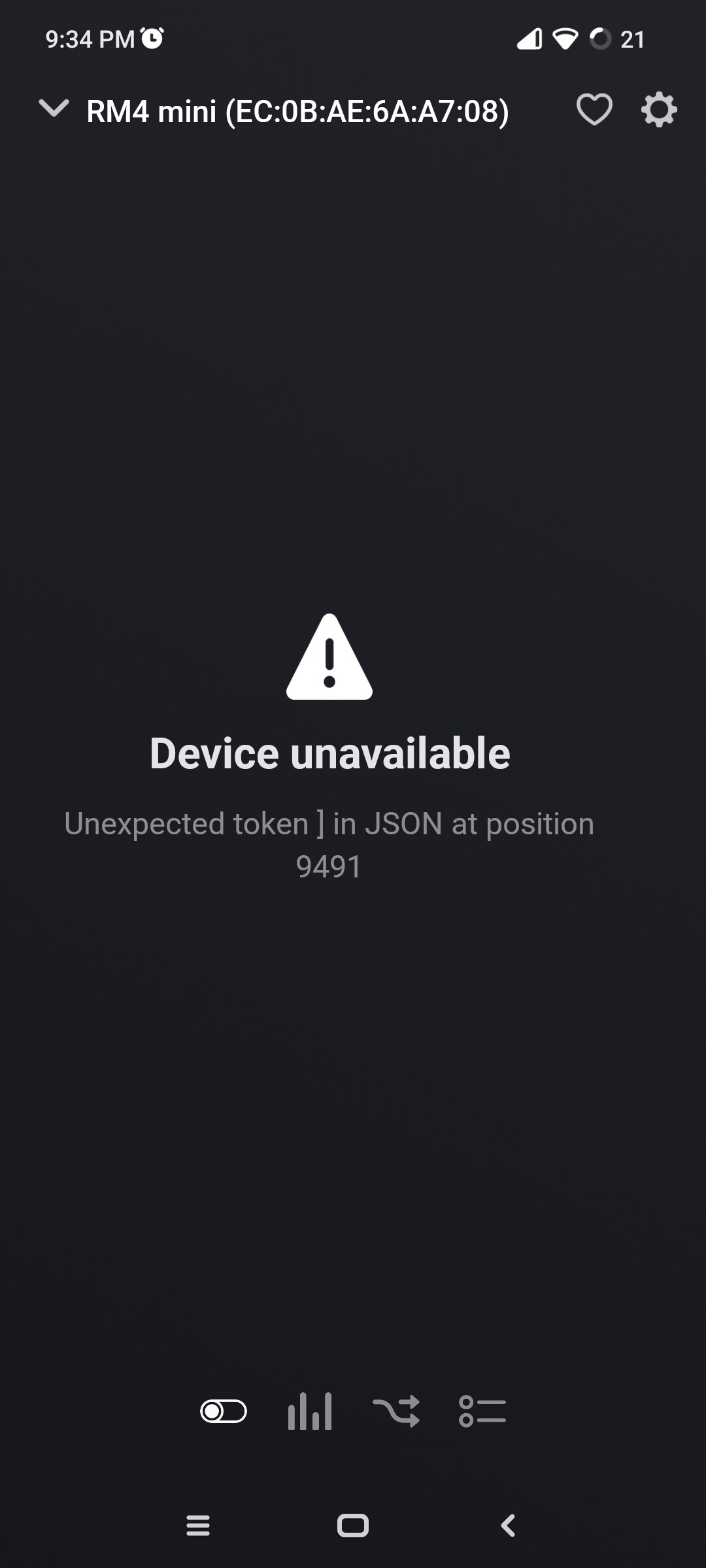

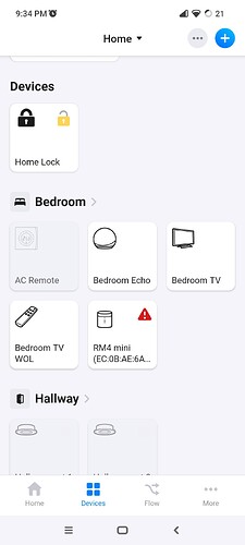

Guys i have an error showing after the upgrade on my rm4 mini … can anyone advise ?
You mean it did happen right after app upgrade to version 3.1.32 ? It looks like that stored JSON got corrupted, weren’t you trying to learn some IR signal and then it got corrupted maybe ? Anyway, please send diag. log and then unfortunately you would have to remove the device and add it back again, until I find the root cause of this behavior ;-(

And yes i just installed it yesterday and made it learn couple of AC commands and it was perfectly working then on the timeline i noticed broadlink has been upgraded today … after that insaw the screenshots i mentioned above

Btw, weren’t you renaming commands right after learning them and renaming them all in one shot ? This seems to break JSON for me, when trying to replicate it.
Yeah i was indeed after learning the command, i rename it and did this for the 4 buttons i needed but it used to work after that
What is the best practice in that case from ur point of view
That should work naturally, doesn’t matter if you rename 1 or all commands :wink:
I must fix it (in former version this code was completely broken). Thanks, then seems I’m on right track.
At this moment, to be on safe side, I would suggest to rename each command individually and press each time save - but I hope I will be fixing it soon.
