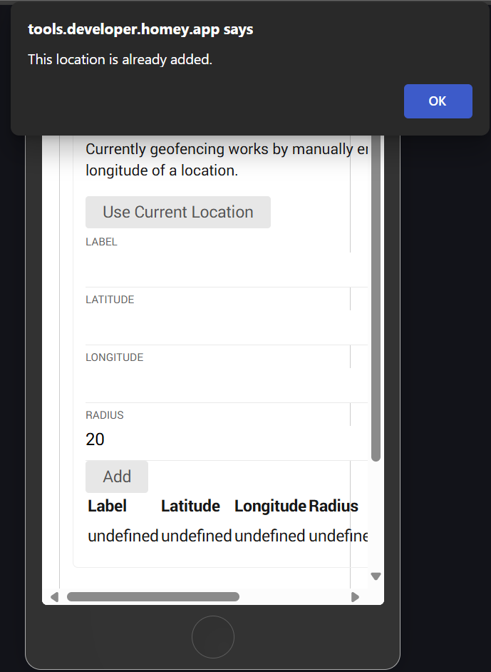

Geofencing labels disappearing
I have added 4 labels, but they seem to disappear 1 or 2 days after they were added. In the app interface the screen looks like this:
I am running the 0.7.8 test version, not sure if this issue is related to the version I am running, but I would appreciate any hints if this may be the issue.
