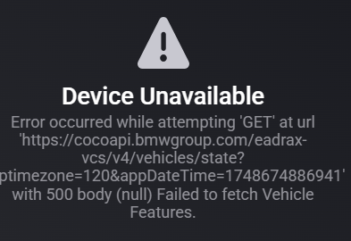

Unfortunately I encounter still device unavailable errors also with v0.7.7. Restarting the app solves the problem immediately (for a couple of hours or days)
As mentioned earlier this is not an issue in the app itself. This looks like an issue with the app communicating with the bmw server. What is the version of the homey server? Maybe disable ipv6 and try…
Using Homey Pro v12.4.6.
No IPv6 using on the LAN but I’ll be investigating further, thanks.

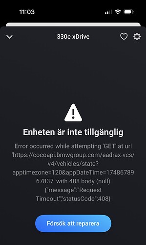

Same issue here since a couple of days. Not sure what changed…?
Different error message here, but this seems to happen every hour or even more often. This happens just after the log record "Adding capability ev_charging_state to device ‘carname’
Is there something we can debug (with HomeyScript)? Ik have found an article about handle the node.js ‘getaddrinfo ENOTFOUND’ error.

Been having issues with lost connection for several weeks now. Fail 1-2 times a day at least. Worked perfectly until 0.6.4 update and after that failed constantly. Removed vehicle and added again, still same issue, cleared token as well.
Will push a new version where you can use a setting in the device to never put the device to unavailable. It will keep retrying and if it fails it will be silent.

Exactly same error now, restart the app every hour now as a workaround.
Hi All,
Please realize that this error was always happening as nothing changed on using the bmw api itself. As part of the streamlining of the login flow this unavailable marker was added. Previously the api would fail but no error would be reported anywhere. Thats why a lot of times people complained that there have been no update for a while.
Currently after a few failures the device is marked as unavailable and further attempts to communicate is stopped. Once i have some time i will push change where the attempts will keep continuing and mark the device again as available once the communication is reestablished.
