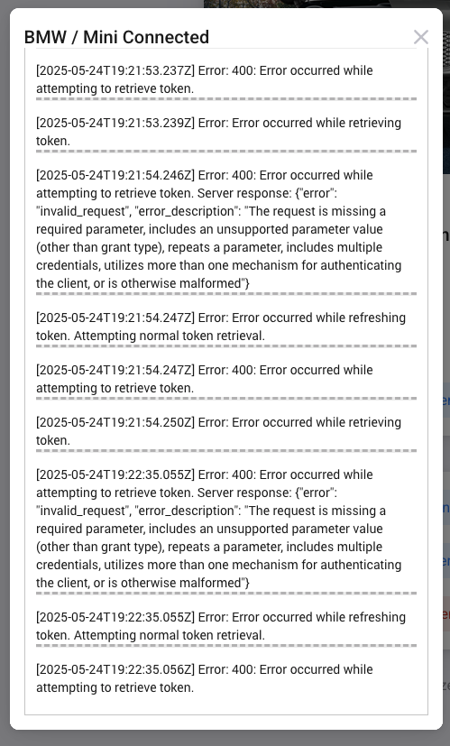

just noticed, that it is no more working. Any idea?
@Michael_Fritzsche which version of the app are you using?if using the latest go to the app settings and in the developer tab and clear token and then try repairing the device
Hello, I am facing this issue. I do not have an e-car. Latest version of app installed.

@Blooddrunk will take a look at this and will push an update soon.
@Michael_Fritzsche you can try to switch to vpn or maybe use mobile hotspot and connect your homey to it to workaround the captcha throttling. Otherwise you will have to wait it out.
