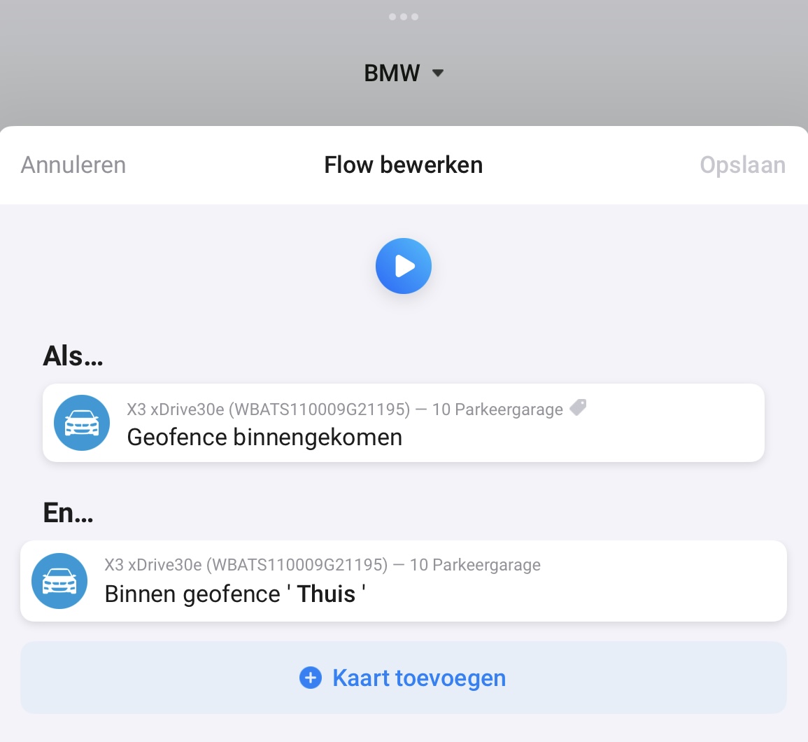

I want to use the geofence feature (e.g. ask me to open the garage) - but only the “When” “alarm triggered” card is working. I tried out all the other cards (e.g. fuel / location changed / geofence entered / drive session completed) but none of them is working (triggering). I just did a simple flow “when” → give me a push msg… i don’t know if it is depending on your car. In the BMW app i can see where my car is etc…
Only when is not enough, you need also an “and” card: see example.
When: entering a geofence
And: the geofence is home
thx. unfortunately already have that in place → but it doesn’t work (i even got the exact gps coordination via bmw car data export)
all the following steps never worked thats why i made seperate ones with the “message” on the phone… don’t know if the car is too old or some other bmw corresponding error… but i can work with that - was just curios if other ppl have the same problem

Yes i have the same problem with a 530i from 2021. I want to do the same thing but for me my flow cards doesnt work either
Same here (BMW X3 PHEV). It seems like it only works for a couple of days and then stops. Only getting a new token solves the problem. Is there a permanent solution for this ? Thanks, Idso.
PS: I am trying to open the garagedoor when my car is within the geofence. I am not getting any location information and the app will not store a new location without refreshing the token.
