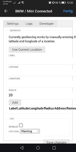

I use the Homey BMW App with my BMW X1 Hybrid. It works stable so far, but I created a flow to automate the opening of my garage. Everything seems to work, except setting the variable, that the car is on the road… when I set this variable manually, the garage opens! Even when I start the first sequence manually while the car is not at home, the variable is set correct…
Can someone help me how to make it work?
Why does the first sequence not set the variable, when the car leaves home??
Please see screenshot attached!
