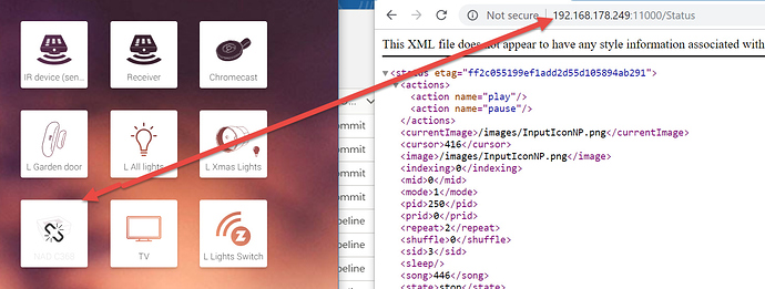

It looks like somehow someway, these devices go offline while they are not:
The test connection shows green light. But even restarting the app isn’t helping.

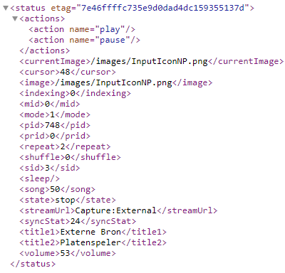

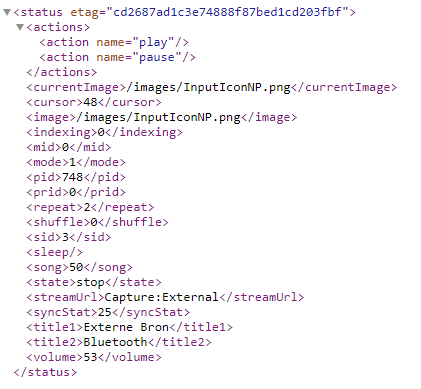

But I did a little bit more research and checked what the differences when calling the Status command being on different inputs. And I was almost happy. Because, the JSON that’s return with calling the Status command for the inputs Platenspeler, TV, Bluetooth have the same structure but the BluOS is different. Let me show you the results:
What do you think? Could you build a card that is a ‘switch input card’, with free text. And you do something like:
Switch input API-call
Status API-call
If (title2 matches ‘input-field’ e.g. Plantenspeler) { stop }
else { start-over }
The only issue is title2 works for Platenspeler, TV and Bluetooth. But not for BluOS. So that needs to be an exception.

If you are not checking whether a device is online using the API and you are doing a PING. Maybe the device has a built in firewall or my router has a firewall or some kind of protection somewhere and blocks your pings to check whether the device is online.
The polling frequency (setting of the device in Homey) is used to make a connection to the device and retrieve the status. If no valid connection can be made the device will go offline and Homey will try to reconnect every 63 seconds to see if the device is available again. If you woul do a CLI install it might tell you why Homey is not able to make a connection to retrieve the status.
