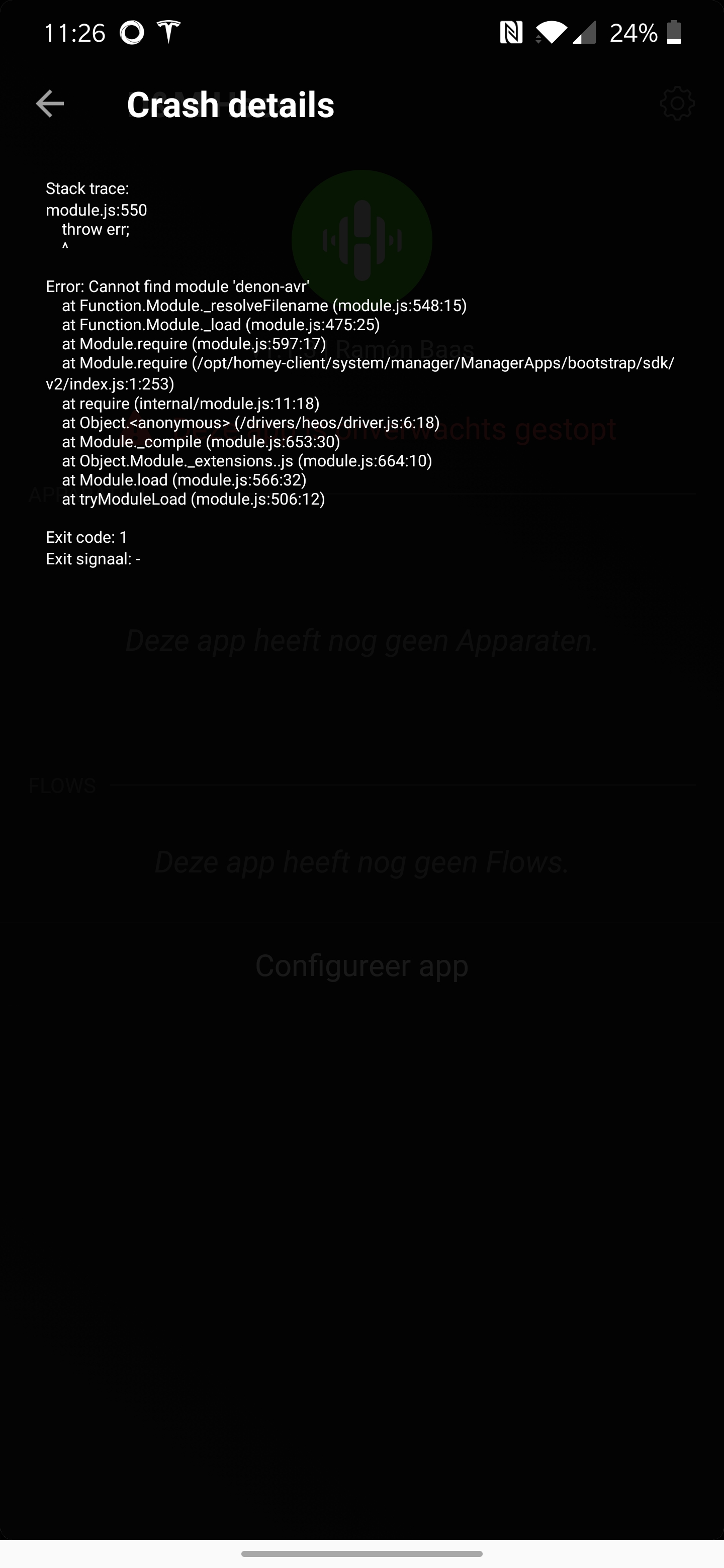

Hi, installed the app, it crashes over and over.
Stopped the Marantz app, no succes
Removed Marantz app, no succes
Restart homey, no succes
Re-install Heos app, no succes

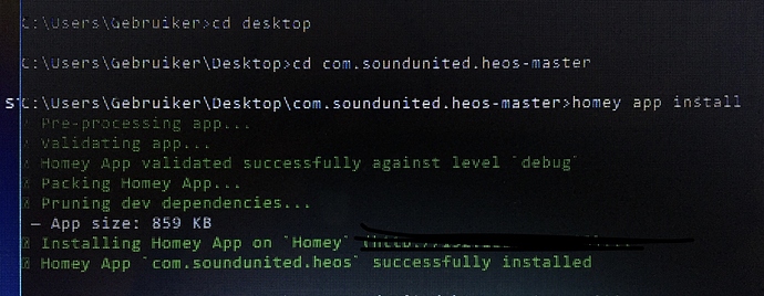

thanks for the app! I think it’s really great.
I just installed it, no errors at all in CLI.
But when I open my Homey app the first thing I see on my timeline is:
the app D&M Heos has stopped working.
When I restart the app it says: Crashed during loading in a red window on top of the app.
Windows defender started freaking out trying to download the latest version from github (a false positive, as there is nothing that can have the trojan is in there), this might be the cause of the module not being there after downloading
thanks for your quick reply. My windows defender didn’t gave a problem, but still I tried again. Make sure everything is right. Still same problem… what could it be?
