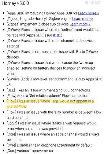

I guess it’s a Problem with Homey Firmware v4.2.
In Homey Firmware v5.0.0 it’s already fixed.

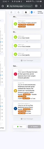

Just created something silly with a couple of Tags.:
https://homey.app/nl-nl/flow/lg9oxu/
Although I am pretty sure the used Trigger card should not be used with Tags as the names of the BetterLogic Variables should be mentioned separate by comma. (But that is a BL thing…)
So don’t use the Tags there but type Helderheid, Datum (if that where Better Logic Variables. :wink: )

[[2021-02-14 17:57.20.707 Flow MusicCast service Select w.typedTags. Het Casten van 1 van de Muziek Services is gestart. Welke? -Spotify: Cast_Spotify -Youtube: Cast_Youtube -TuneIn: Cast_TuneIn]]
So, the write-the-tag-name-instead-of-pick-the-tag should be done by default within BL cards? Or just for the one “if a var has changed” card?
The pick-a-BLtag in THEN section is functional in non-BL cards, but the tagnames still aren’t shown in a shared flow.:thinking:
Here’s he adjusted flow as a shared flow:
https://homey.app/f/x-ptxu
Here’s the functional flow, see P.trails log [[2021-02-14 18:35.47.595 Flow MusicCast service Select: Spotify: true YT: false TuneIn: false ]]:
https://homey.app/f/XKkCxu

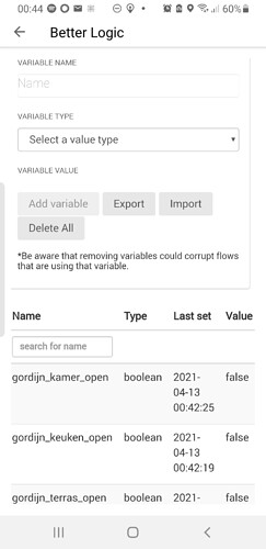

I have a simular problem and not sure how to solve it.
I want to start a flow using: One of these variables changed
I type in (for test) my logica values: gordijn_keuken_open, gordijn_terras_open
And in THEN i do something, tried send push and log etc
It simply does not work, also tried to select the tag cards but this also does not work.
When i test the flow then the flow works, but when the value changes nothing happens.
The logica values are all true/false logica values
Anyone an idea what i do wrong here?

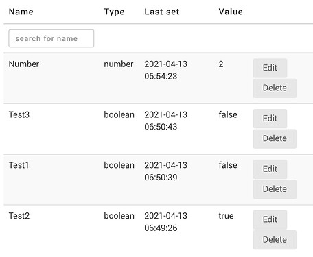

  1. I Added 3 BL boolean vars:
  2. The flow starts with BL - One of these vars has changed.
    Here you copy/paste the var names you entered at step 1. with a , as divider.
  3. (Optional) At the AND section, add 3 BL - If True (or inverted) cards, 1 for each var. Now you select your var with the Tag icon button thing.
  4. Here’s my flow: Shared Flow | Homey
4a. Only the tags don’t show @ action cards here (and no one believes this is a bug…). Screenshot of that:
  1. The result after altering every var from false to true and to false again
I hope it’s of any use @B3rt !

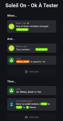

Hi Peter, hi all,
I would like to define a flow with Better Logic conditions, but I don’t understand how to set the text condition :
When Variable ‘Description’ changes AND Variable ‘Descritpion’ contains “clear sky” THEN …
See below :
I’m sure it’s really easy to do this but I do not find the solution :frowning:
Please could somebody help me ?
Thanks a lot !
Hi Hervé
I hope this helps you a bit.
In the BL “text contains” card, you can select the variable at the (…). The text field, where you had selected the variable, should only hold the text which you expect to be stored in the variable
