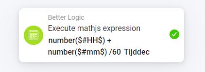

is it possible to convert a logic variable hour into a(nohter) login variable hour in decimals so for example 13:45 would become 13.75. Not sure how to do that.
Make following mathjs calculation every minute
number(#HH)+number(#mm)/60
and save it into a variable

You should write
Noticed also that you use some variabletag in the calculation Zonsopkomst? Remove it. The number() function will convert the hour and minute values into number format.
He did forget to mention the curled brackets {{number(#HH)+number(#mm)/60}}
U sure about that?
Yes in normal logic but I’m using better logic app
