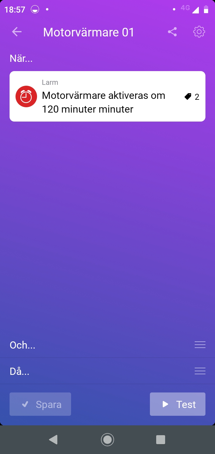

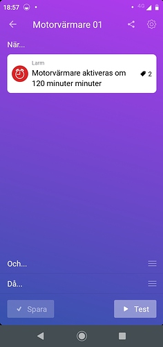

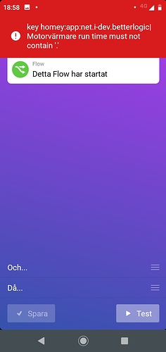

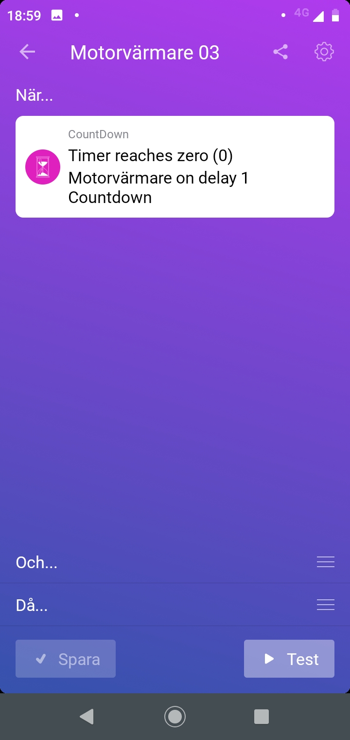

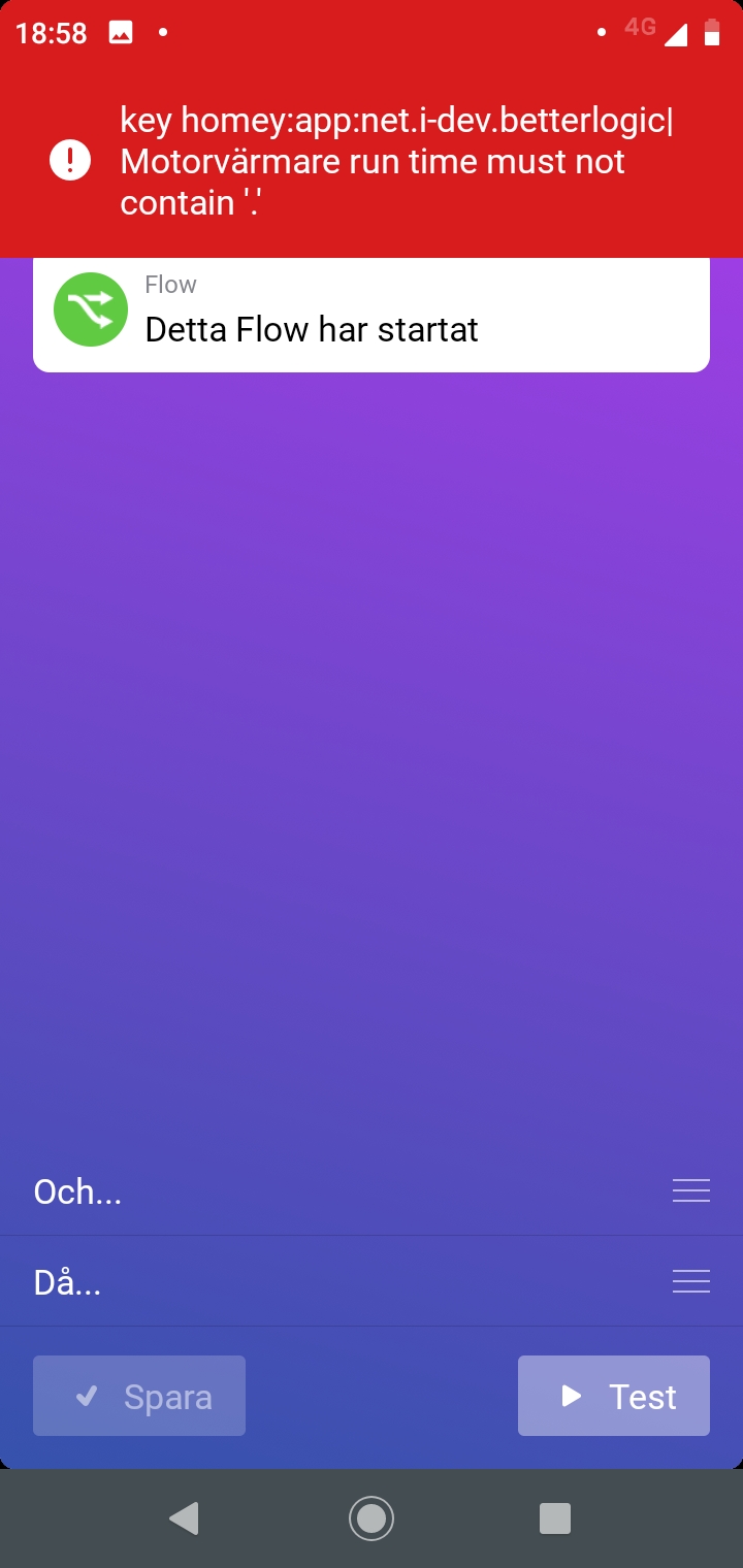

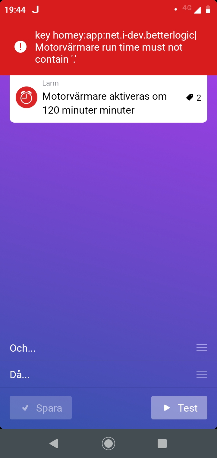

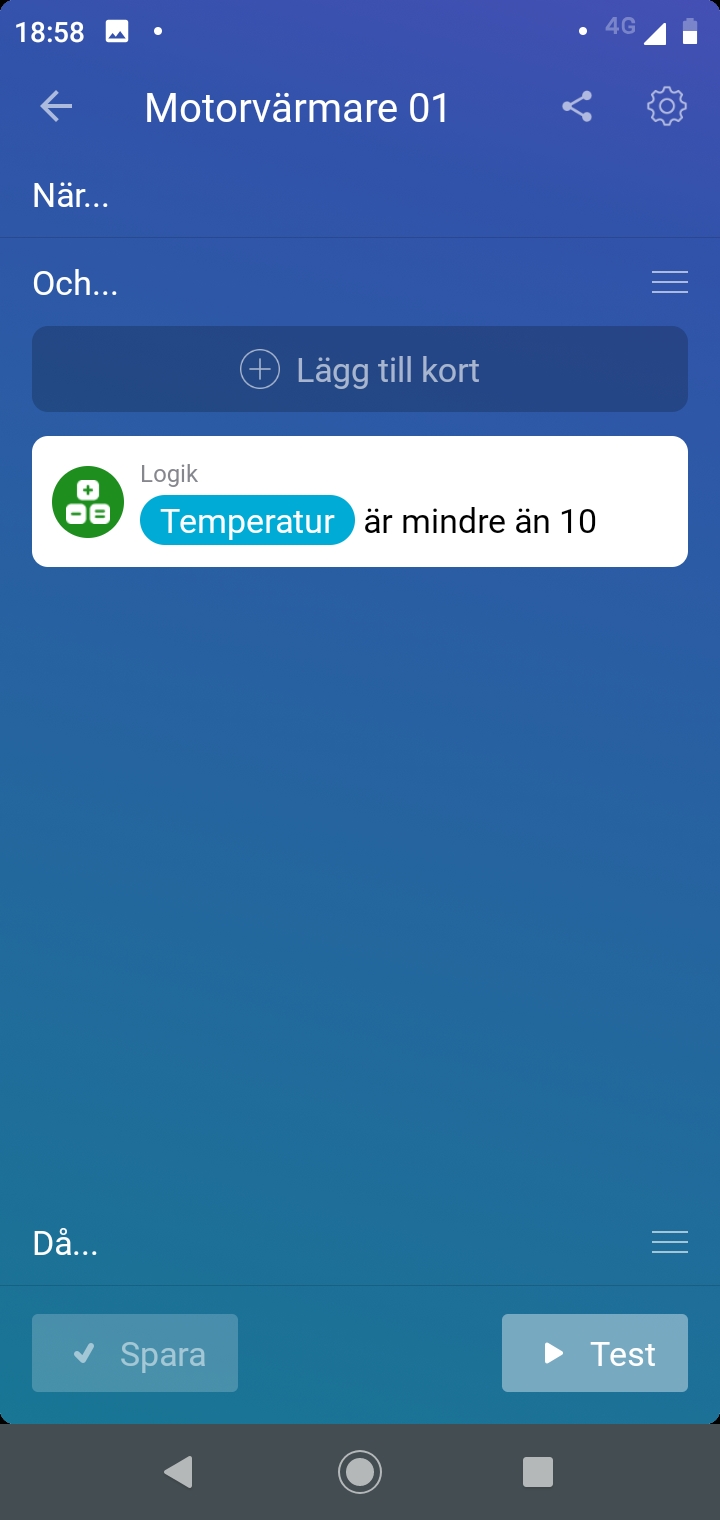

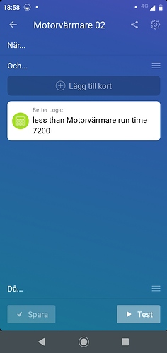

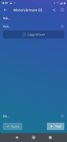

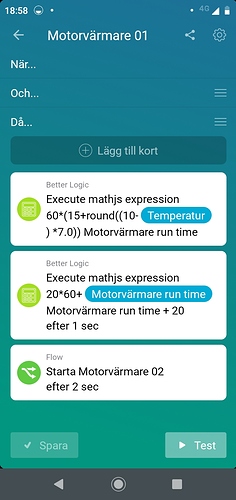

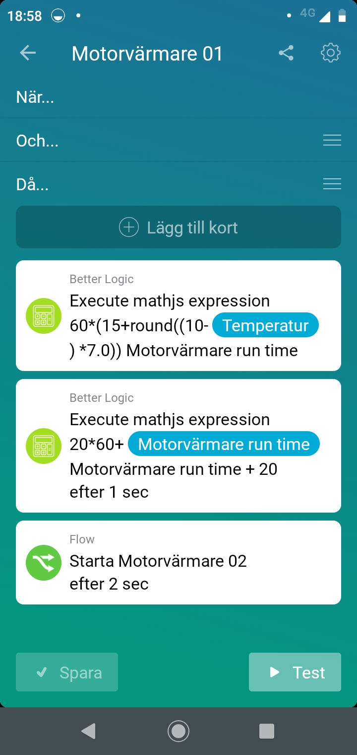

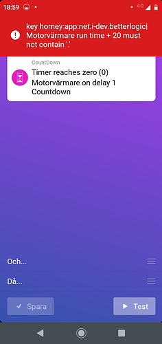

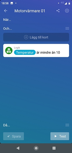

Hi!
I have problems with Better Logic and have not been able to get help.
I enclose pictures of the error message and the flow. It is a total of 3 flows.
When I try to share the flow. I only get an error message. As you can see, it applies to all three flows. I also attach a picture from Better Logic.
I do not know and have not been able to get an answer if there is a fault with Homey or Better Logic.
The flows work as they should!
I think that Homey doesn’t like the spaces in your variable names. If that doesn’t solve the problem, also try removing all accents from characters.
robertklep
I have other flows with swedish letters and space in the name without problems!
But now I have tet to write the flows without swedish letters and space. And you can see it is the same!
That answer I get from the Homey support was they think its any messes with the code of the better logic app?
That is why I write here either for help or for anyone who knows the code for better logic to see if there is anything wrong
When exactly do you get that error? When you test the flow, or when you just open the flow in the editor?
Ah, I can reproduce the problem when you try to share the flow. You should ask Athom’s support where app developers can find any guidelines to prevent these issues (hint: there aren’t any! I have to conclude that this a bug in Athom’s “share” code).

Hi!
I have problems with Better Logic and have not been able to get help in the group.

The error happens when I try to share any flow that uses a Better Logic token. The error is not generated by the Better Logic application (whose code doesn’t even contain the particular error message that I’m getting) but somewhere the Homey infrastructure (in fact, it looks very much like a MongoDB error, which definitely isn’t part of Better Logic, but very likely part of Homey’s “Share” backend system).
Others can reproduce the problem as well.
Thank You very much!
If you can send images as part of your support request, I wrote a proof of concept that will trigger the same error as with Better Logic:
This is the code I used to reproduce:
new Homey.FlowToken('foo.bar', { type : 'string', title: 'foo bar token' }).register();
EDIT: also happens when you don’t use periods in the flow token id:
new Homey.FlowToken('foobar', { type : 'string', title: 'foo bar token' }).register()
So something is fundamentally broken in Homey’s backend system.
It has been brought to the attention of Athom’s development team, and they will fix it :+1:t2:
