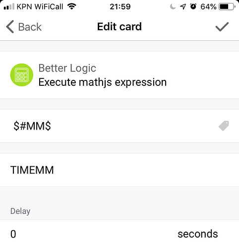

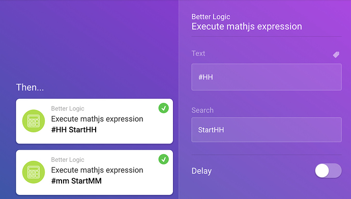

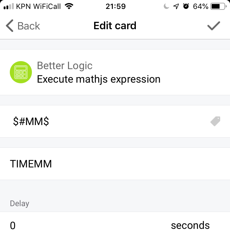

Hi, how have you been able to use the time in an expression? I am trying to copy time (#HH and #mm) into 2 separate variables. However, the variables change to empty
Any help will be apreciated
You have to use dollar sign. hope it works
Don’t know what I did wrong, but now it is working. Thannks very much for the fast response!
