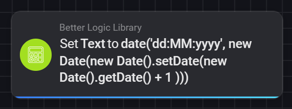

I’m trying to set a Better logic variable as the date of tomorrow. (written as DD:MM:YYYY). Anybody an idea how to set a variable that wat? Would be great! (Would like to use that variable as input for another app, so it must be exact that format)
Use a Set [variable] to [BLL expression]:
date('dd:MM:yyyy', new Date(new Date().setDate(new Date().getDate() + 1 )))
Thanks for your fast help (again!)

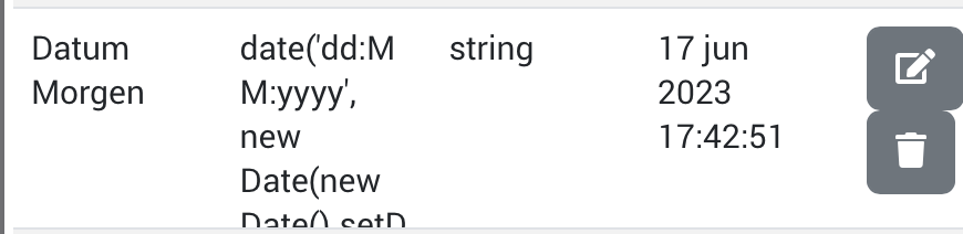

I think that I’m doing something wrong…
I see the inverted version (variable to text). But when trying that, the value is set to the complete BLL expression. Any idea what I’m doing wrong?
Result: (Field ‘tekst’.is set to ‘string’')
Possible (Then) options:
Edited: Sorry, don’t know why but was replying in Dutch…
@Ranney
Yeah, sorry, you need to use the card Set variable to BLL expression.
Ja, je moet de set expressie kaart gebruiken, niet de set text.

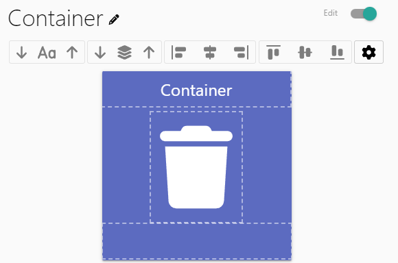

I have created an Container AVD with one field:
BLL expression: !$value.trim() ? '' : 'Morgen: ' + $value
This can be added in the Sharptools, where i created a custom Super Tile:
In the bottom field, the text from the AVD is shown.

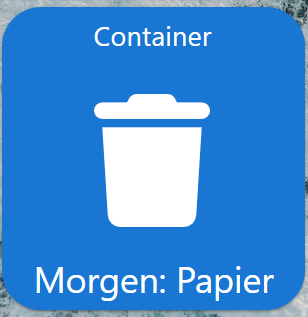

Next, in the dashboard, where the tile is used, i have configured some colors based on the values:
The result, based on a BLL variable is this:
