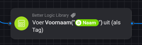

I want to extract only the first word from a string-tag inside an advanced flow. And I’m sure it should be possible with one of the cards. But I’m can’t find some examples how to use the BLL functions.
I want to do something like this:
to extract only the first name from a tag. But I have no idea how to use it or if I am on the right track.
Well, remove the var tag line, and place tag as argument to the function (between its “()”). Thus: function(tag)…
Then, you can use the Execute BLL expression as Tag, write Voornaam([[token]]), and run the card.
Thanks Arie. Took a bit of trial and error but I got it working. Turned out I also needed to put the tag between quotes. :sweat_smile:
