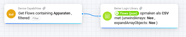

BLL just got a new Flowcards: Format JSON as CSV or Excel
This will allow any JSON input array (or object-array) to be converted into a CSV (or CSV-base64).
Also, Excel:
Its in test now.

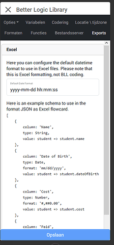

Excel files can now be generated with a Schema (in test):
Check the App Settings for an example (and other Excel settings):
BLL variables can now be downloaded as JSON or Excel on Mobile or Web or anywhere :slight_smile:

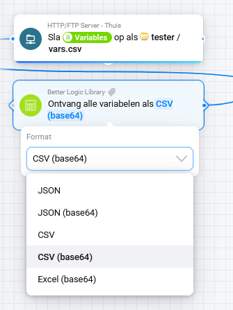

The idea is to create the same flowcards i just created for Simple Log:
Export the variables (or Log in SL’s case) through flowcards (automated) as JSON, CSV or Excel (give people the type the need), as text or Base64 file, so the can uatomaticly save it every day.
In FTP Client i have already build in a new flowcard to save Base64 files, thus: You can save the Log/Variables every day on a FTP (on Homey itself for instance).

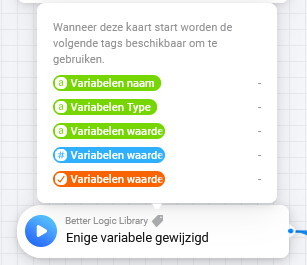

There is a new trigger flowcard: Any variable changed (not the old debug version, but the new one with tokens).
It contains the Variable Name, Type and the value as type:
With this single card, you should be able to log every variable change to the InfluxDB.

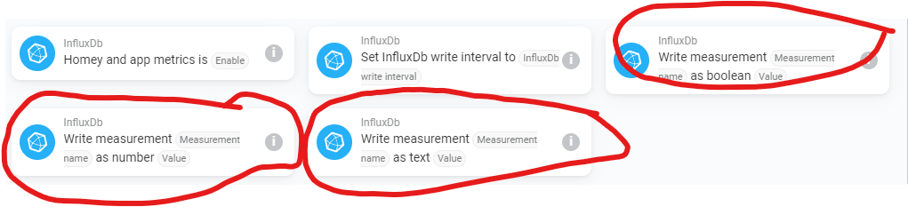

In the App Store it shows verious cards to write single record:

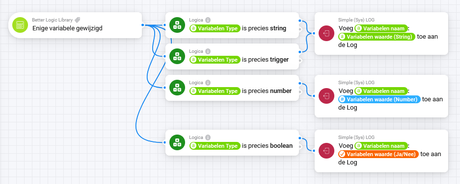

You can combine these to get this (im using log cards):
First: Any variable changed, then check what type it is (string, trigger, number or boolean), then write the specific value to the log/DB.
do you want to update influxDB each time a variable is changed?
Yes, every time a numeric variable is changed we need to send an update to InfluxDB and doing that with flows Homey will disable the flow frequently, because the flow runs to often, so it a numeric only changes every 10 minutes then it can be done with flows, but if a value changes every few seconds or every minut, the flows will get disabled, over and over again.
Why?
As long as the flow is not running, i believe, 60 times at once, it should work just fine.
Please test it, if indeed the flow get’s disabled, i’ll try to work on another, more integrated solution, deal?
