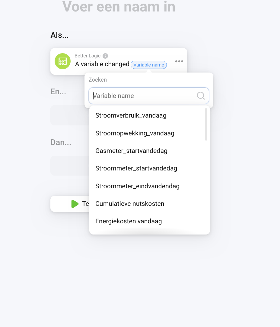

I tried to create a new (standard) flow. The trigger card is a Better Logic card with a variable I wanted to create ‘on the spot’. But that does not work (for me).
This trigger does also not except to make a variable on the spot:

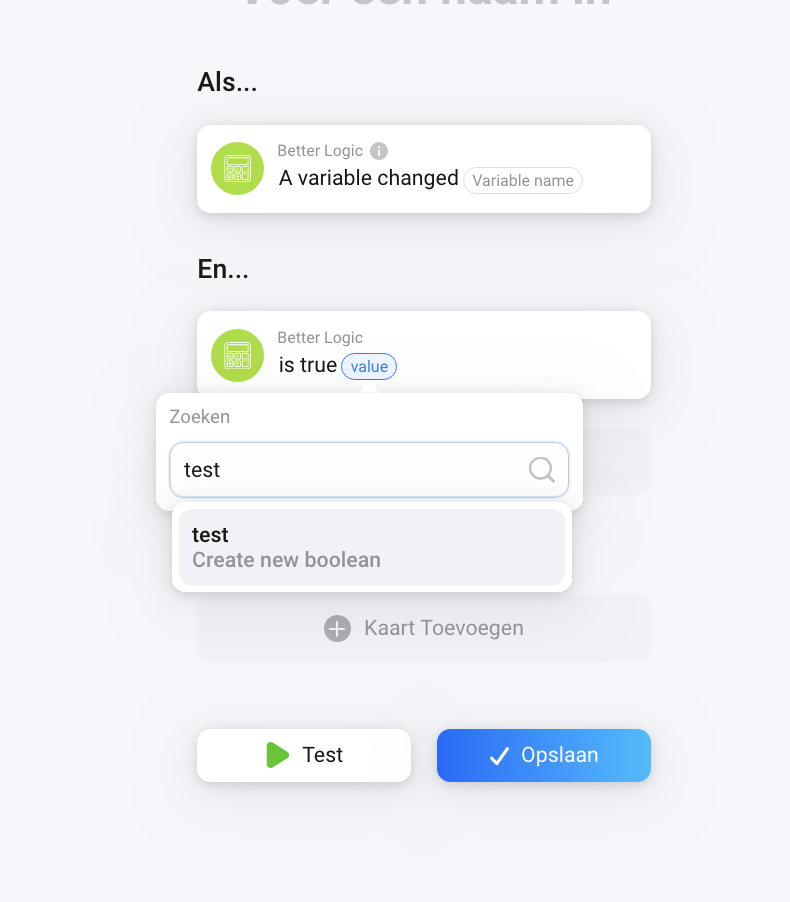

In the AND section, it does work :slight_smile:
No, im sorry, Better Logic only has one Trigger/When card for when a Variable changed.
So, if you would be able to create it there, there is absolutly no way the app/i can know what kind of variable you want to make.
I am thinking about adding extra When cards for Trigger/Text/Number/Boolean, but i am not sure.
