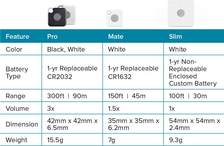

What is the typical range (meters) in which a tile is detected?
Please read the openings post:
Here is a list of used devices
* Tile Pro (8m)
* Tile Mate (8m)
* Nordic nRF51822 (5m)
Thanks Koktail. I saw the opening post with the ‘(8M)’ marking. I thought it was a type marking or some kind.
Their website says 90 meters:
So 8 meters depending on the model?
Any reason for the range decrease from 90 to 8 meters?
Wall for example.

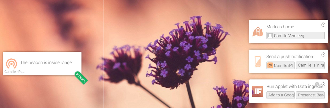

I have two flows per Beacon, one arrival flow and one out-of-range flow. Example:
That’s it. That’s all I know. I really hope you can figure it out.
