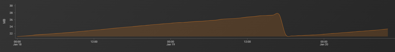

I see this behaviour last night:
At 17:00 (around that time at least) the memory drops back to 20 from 27MB.
I see this behaviour more in the past, and not all those times I did restart homey or the beacon app. I almost never reboot Homey tbh.
So maybe, it grows slowly, but not unlimited? Or does the homey core or the app itself restarts the beacon app somehow?

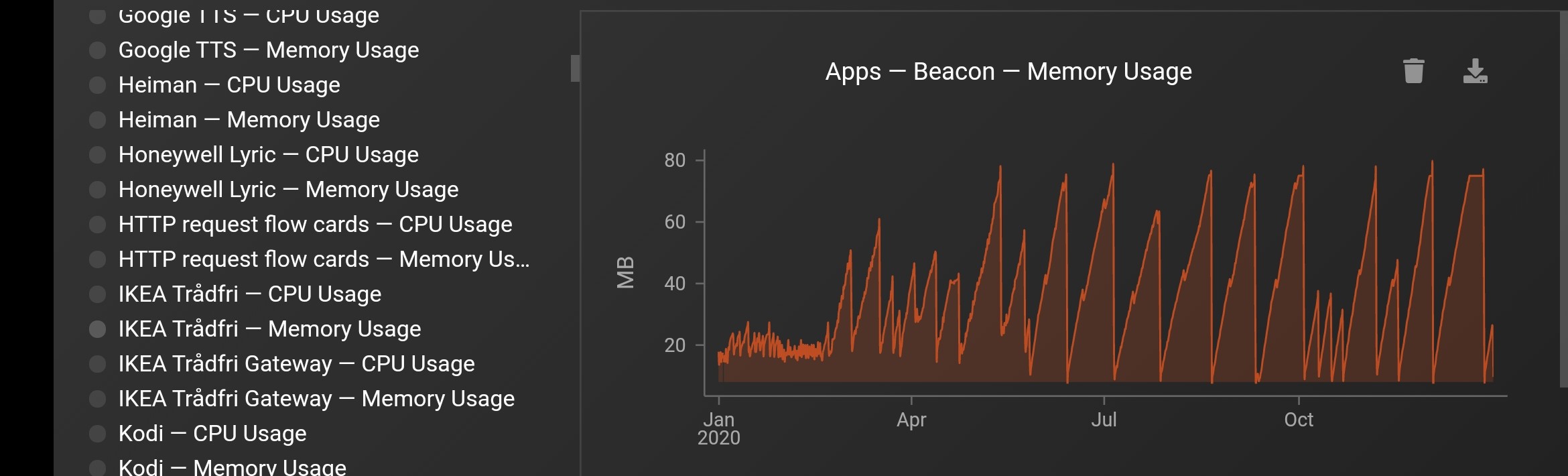

Since October no more memory usage then 40MB, and dopping again every few days
I think the garbage collection mechanism from Homey core is cleaning up instances that aren’t used anymore to free up some memory.
That makes sense. But does that mean there is no actual issue?
