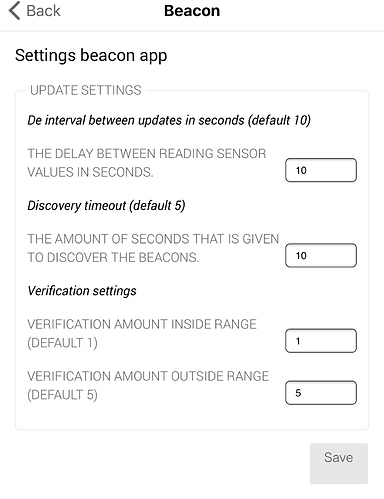

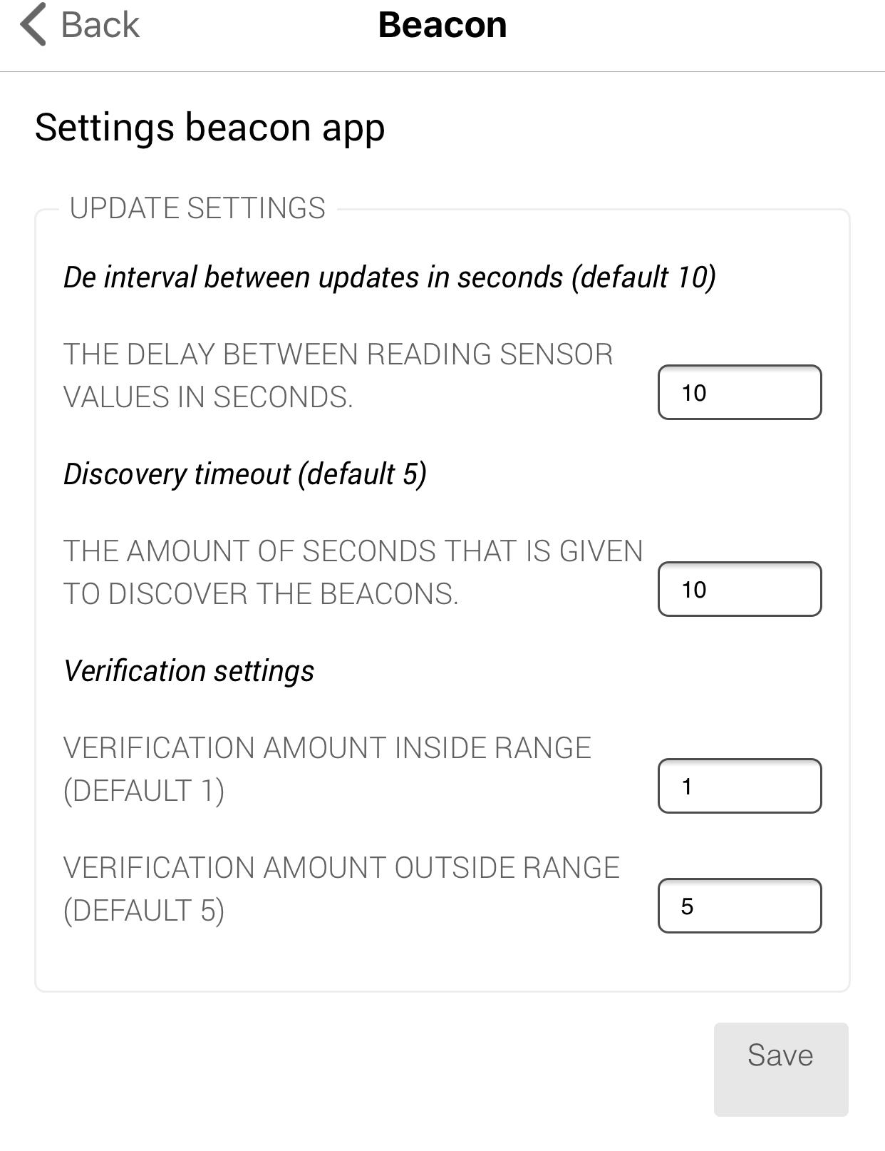

Quick question everyone, what default settings have you found best to work for you??
Here is mine, below. It defects the beacon presence fast, but it takes some minutes to have it reported gone once out of rage.
I use the same settings as you!

Looks like you have memory issues. What are the settings of the beacon app? You could try to increase the delaytime because that can causes some issues.
nl.philips.hue https://apps.athom.com/app/nl.philips.hue
I used the default settings.
I changed it now to 20/10/1/5. Lets see how that works.

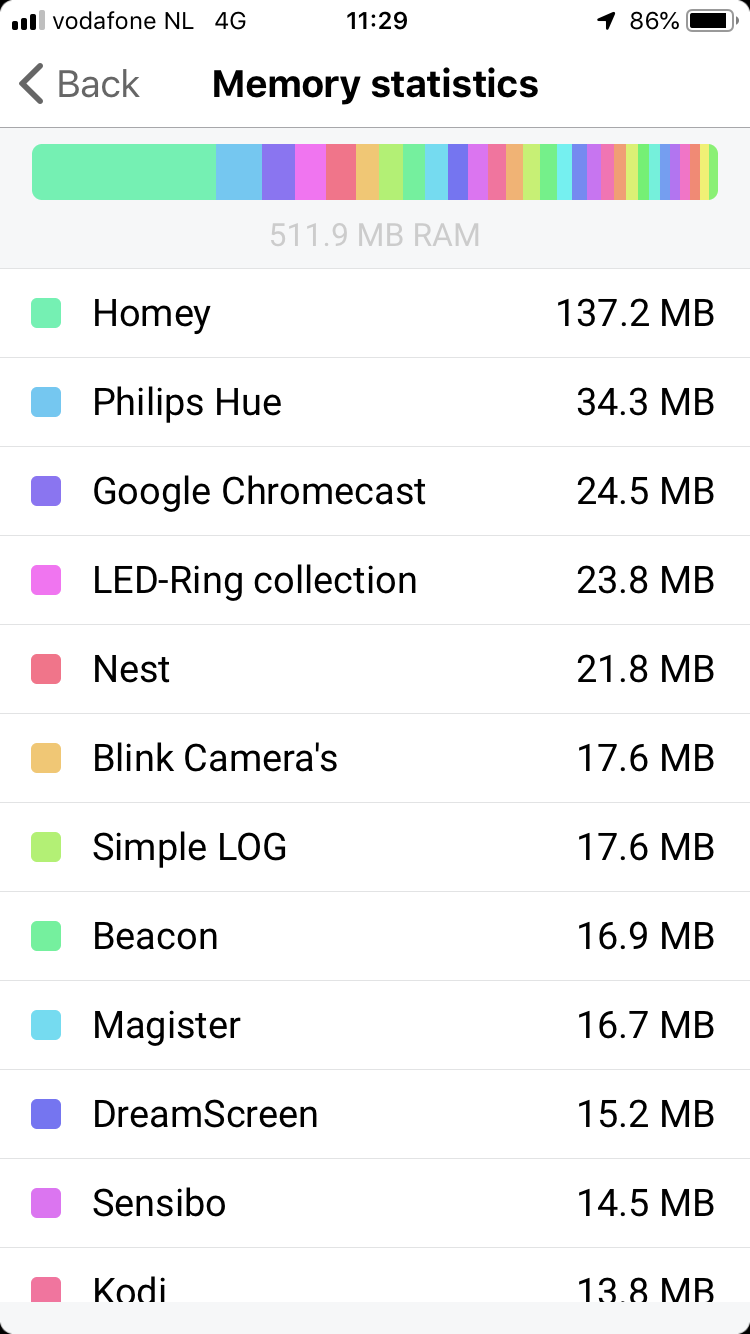

Can you send a screenshot with you insights of Homey memory and CPU?
I am experiencing the same issue. If I go to my devices tab, many are not responsive. Specially the HUE’s.
I did not had yet had time to investigate.
I don’t use the devices tab often. But it’s slow as hell
