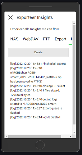

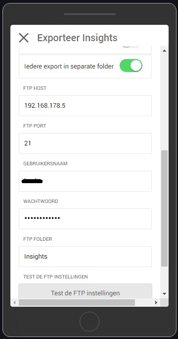

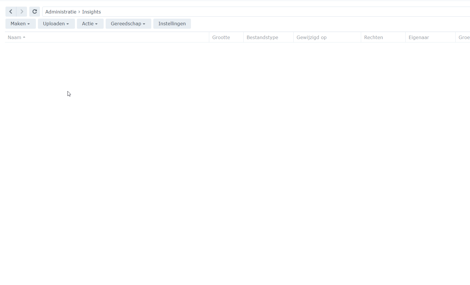

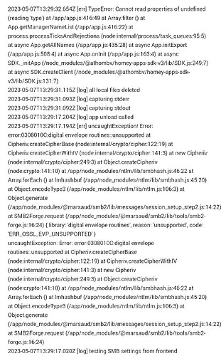

SMB does not work for me. With FTP the app says it’s ok to save the settings so I assume the settings are correct than.
The log says all items are exported but I don’t see the files in the folder where it should be.
Any idea why I don’t see the files?
Thanks.
Edit, the exported files were places in the music folder. No matter what link I put in the FTP folder, it is always placed in the music folder.
How do I get it in the folder I want it to be?

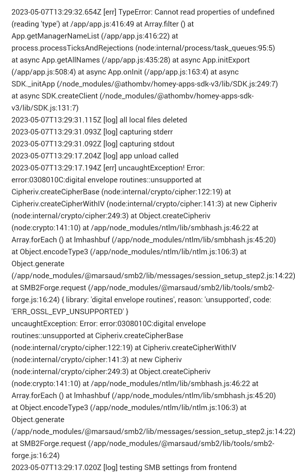

Hey @Gruijter. Just checking: it seems Archive Insight is not working on the Homey pro early 2023?
  • FTE connection is OK (“OK! sla de instellingen op”)
  • When selecting he tab “Exports”, the dropdown “APP” only shows “alle apps”, no other items.
  • When selecting “Exporteer nu”, is says “Are you sure… etc” and then “Export is begonnen”
  • The Log shows “Export que is flushed”
  • BTW: When I select “Delete” in the “Logs” tab, the log apears to be deleted. However, when I leave that tap and return to it, the log is still there.
After that: noting happens anymore. Maybe it’s a know thing that I missed. I did not yet report this to Athom, first wanted to check.
ps: it does still work on the old Homey, it appears to have someting to do wirth the homey pro early 2023
also not working here on HP2023 - SMB
592b6887-bdcb-4ce9-b9fd-88c1326575b8
Correct. Working on HP2023 compatibility as we speak. @Arie_J_Godschalk already did most of the rewrite. I just need to debug some more and finish it.
My version is working, the issue had two part to it:
The way homey-api references the uri and id, whicch is changed with logs/insights/devices etc.
The other part was that i had wrongly converted logs from the migration.
Both is solved in my current version for hp2023, but i temporarly have no hp2019 to test (not gonna reset it till i know for sure it the hp2023 works correct after my real migration yesterday, altho its looking good!).

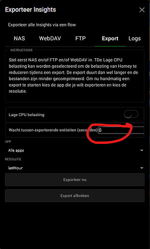

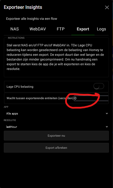

  • You wait 10 seconds between each entity, to reduce overloading.
    But with 45 apps, that 7.5 minutes waiting for nothing!
    I have created a settings for it, by default still 10 seconds, but you can change that now.
    When set to 0, the timeout will still be 1 millisecond, so the process will not be killing homey.
    And for me, 0 seconds works fine and there is no crashing issue or anything.
