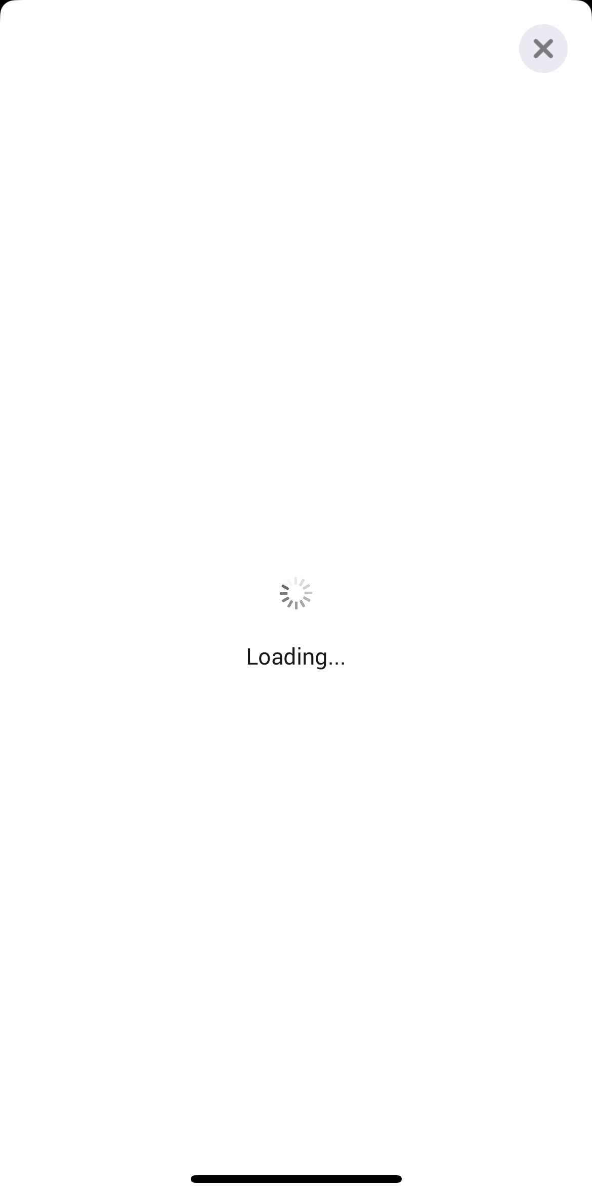

All info is correct and when logging in, it just stays on “loading”.

Same problem for me. After installing the app i’ve entered my credentials. After that the message “ loading” remains there. Nothing happens. Tried via webversion, same problem. Restart Homey, same problem

No I am not able login as it says “Loading”
