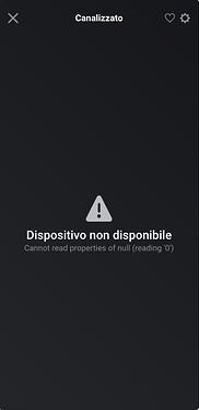

It gives me the following error:
Schermata 2022-06-25 alle 18.11.11
No , this is not a known problem.
Can you share your flow so i can reproducei it?
Which version homey firmware your running?
Can you delete it again and add it again?
After that send me a new diagnostic report
Report id: c3a77665-cb08-4e60-8b6b-125bcbde2be7
Thanks, i have seen the problem, that a fuckup from my site.
Please install latest test version V2.2.3 from https://homey.app/a/climate.onecta.daikin/test/
Same procedure : delete device, install test version, add device again.
Let me know how this works?
