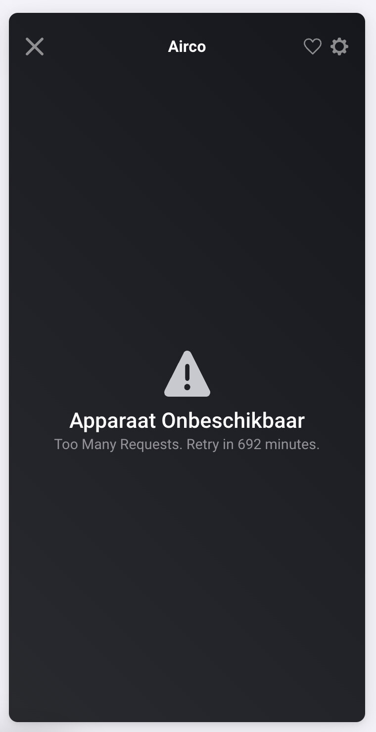

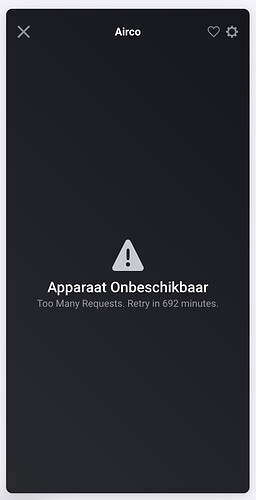

Today they became completely unresponsive. Tried restarting the app, now receive an error (see attachment).
Hope the new update fixes some of these issues as well, because after the Daikin Cloud update it does not feel stable.
Complain much as you want but the new update doens’t fix these issue’s as these are mostly in the daikin platform.
A. Daikin cloud platform is unresponsive last week. Check : https://daikincloudsolutions.statuspage.io/
B. If you send to much request (+/- 150 day) then you hit the ratelimiter like in your screenshot. This is caused by youself or your flows.

I understand your frustration, but it is not completely reasonable.
  • The units a performing unexpected actions for a longer period of time now, not only since last week.
  • The units are migrated to a new Daikin account since the last API update, and are not performing more than 150 requests. I never had this rate limiter before.
It seems that there are other issues going on with the Homey app.
I’m not frustrated , looks to me you are beacuse of you messages?
There is nothing wrong with the homey app… the app is +/- 6000 times installed and you are at this moment the only one complaining.
The homey app does not send random commands toward the daikin platform!! Only with flows or manual action on the mobile app or webapp there will be a api call!! And the max is 200 per day , where the 1/2 hour polling (48 times) is taking in account ( 150 call left)
The homey app gets this info from the Daikin Cloud PLatform so somewhere you hit the limit…

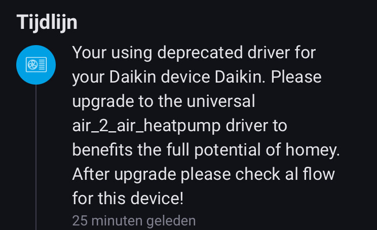

I get this message now for my Daikin Perfera.
I have the latest test version of the Onecta app.
What do I have to do?
In the Onecta app I can not find a firmware update.
The update is only for AC models so if you want the energy readings migrate to the new driver…check your flows after the migration.
Remove your current AC device and add them again thru normal pairing process.
Use the new driver AIr-2-Air

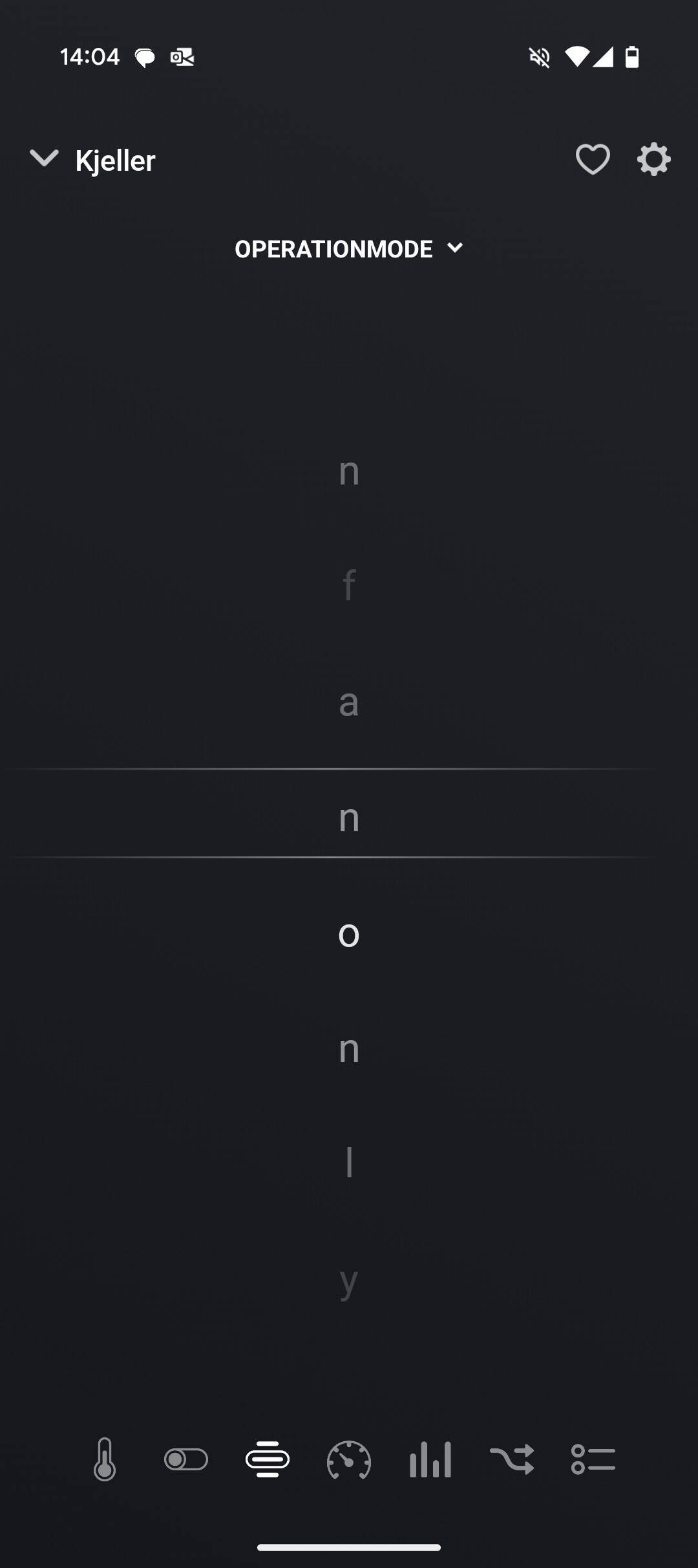

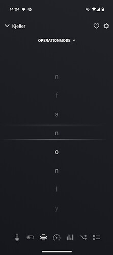

I tried changing the operation mode, it gave me some errors and now the display is broken. It list all the letters in “fan only”
