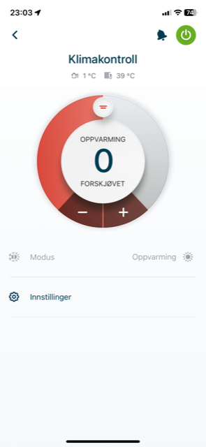

Hi.
I am the proud owner of a Air/Water Daikin Altherma 3 M Monoblock, and it shows up in the Homey app as a Altherma III - ClimateControl. I am able to get the “Leavingwater Temperature” and “Outdoor Temperature”, but I am not able to set the setpoint for the watertemperature.
This can be done in two modes, either relatively when the heatpump is in “outdoor compensation” mode, or absolute. For relative mode, I can set +10 to -10 degrees and in absolute mode I can set the watertemp for +20 to +60 degrees.

The relative and absolute Temp setting is available in the app.

When I change temperature control mode, the app almost instantly updates its GUI from relative to absolute and vice versa. So there must be something in the API that makes it dynamic and possible.

I have just been testing a bit, and the relative offset mode works fine, but when I change to absolute control mode, the app does not reflect this. I do restart the app. I have even tried to add the heat pump again, just to see if that helped.
Any thoughts or things I need to do to get it to work?
With the absolute control.mode you mean your set the heatpump controlmode “room temperature”. Or. “external temperature”?
I set the setpoint for “leaving water” temperature. As it is a air/water heatpump, there are no room temperature to control, at least not for me. I guess the heatpump support a room temperature sensor and setpoint, but for my use case i need to control the water temperature.
