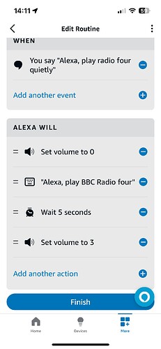

@Andy_Henderson i had the same issue as you with the announcements. They are coming from the bbc sounds app on Alexa so particularly difficult to treat. I had some limited success with a routine on Alexa which I called play bbc radio four quietly. That routine would turn the volume down to the lowest setting, then pay bbc radio 4, then turn the volume back up to where I wanted after a few seconds. Then I triggered that routine via Homey.

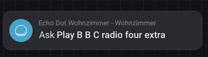

Sure. As @Jonathan_Draper says we can’t use Tunein to play BBC radio stations in the UK. There are four main commands I use:
  1. “play b. b. c. radio two”
  2. “play b. b. c. radio four extra”
  3. Stop audio on …
  4. “Stop playing in one hour”
1 & 2 trigger response “Playing BBC radio two/four extra”
3 doesn’t trigger a response
4 triggers response “OK I’ll stop playing in one hour”
Yes, the commands are executed by the BBC sounds app which occasionally announces “BBC sounds” but, as you say, those announcements are in the BBC stream at the prescribed volume.

This is what kind of works for me: it doesn’t completely mute the “playing BBC radio four” response, but it does make that a lot quieter. And having the delay set to 5s also covers the occasional “BBC sounds” announcements as well. Then after the timeout, the volume is turned back up so I can hear the radio at normal volume.
Thanks for taking the trouble to provide that. I gave it a go, but the volume of the announcement sounds just the same as my usual routine. I’m guessing that’s the minimum volume for announcements. My normal playing volume is 2 or less (the dot is right next to me).
If that’s the case, my only hope is to trigger whispering through the app or a routine, somehow.

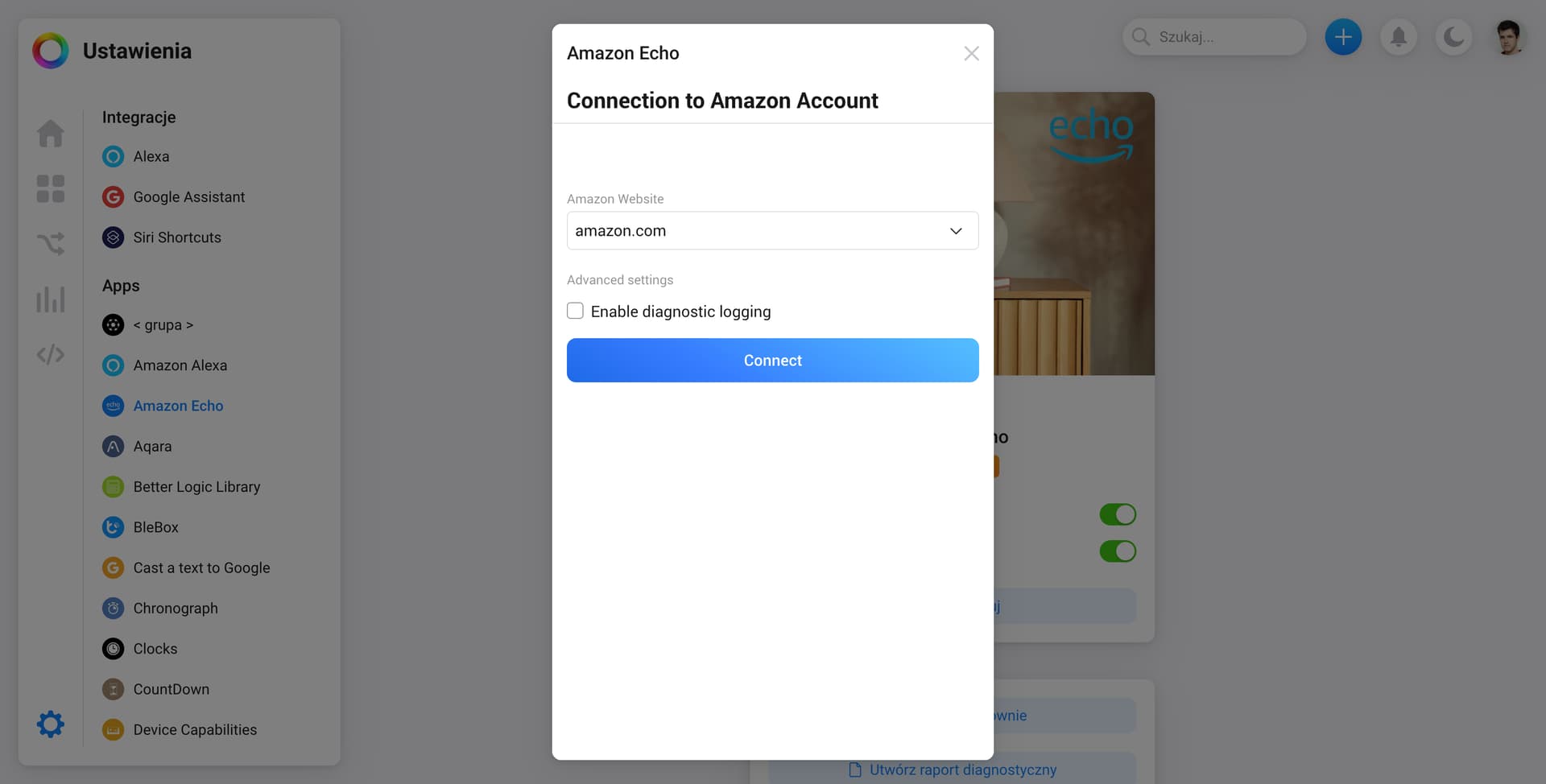

Hi, when i try to logi in I get this messages on evry devices (laptop, phone):
Error: Cannot read properties of undefined (reading ‘replace’)
what browser (version) are you using?
Mac Os: Safari 17.6, Chrome 131,
IPhone: 18 / Homey App
in every place the same

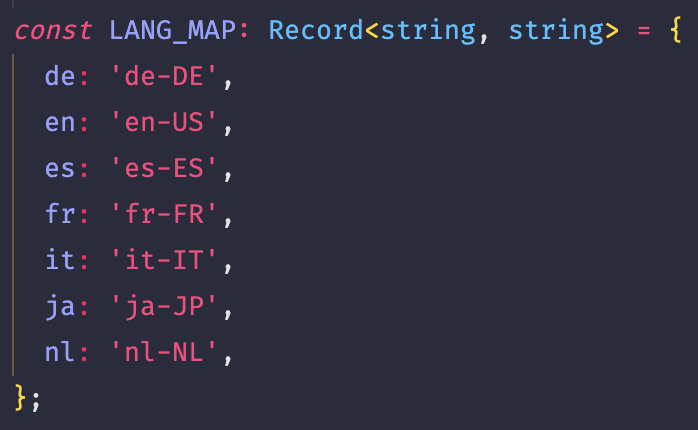

Ah I think I see the problem, might I know what language you are using Homey in? An what amazon country you are trying to access?
Currently I only have those languages mapped, so I think that’s the problem
EDIT: from your screenshot I assume your language is polish. I just released 1.0.6 which should fix this issue, let me know if it works for you now.
