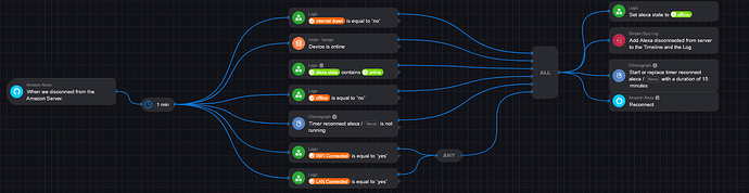

I used to have that issue, I solved it by using the device capabilities app to watch for offline devices, then use the alexa app to reconnect and if that fails restart the alexa app and then try to connect again

just use the device capabilities app to detect when its offline, the Alexa has a reconnect card option, if it is still offline after a short delay, restart the alexa app and repeat the reconnect option. works for me most of the time, maybe about once a month, I have to manually do a repair and log in again.
I also use simple log to get a log of errors when Alexa can’t reconnect
