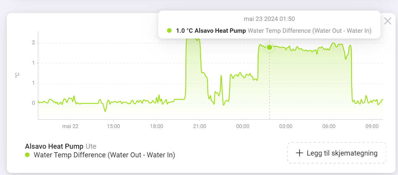

I have one other question. Do you, or others, know why the scale/vertical resolution on this, and some other variables for other devices, is so low? Can something be done? As you can see, the numbers don’t have decimals and repeats on the vertical scale, and even if the graph label has a decimal, it shows as 1.0C when it’s closer to 2C.
Assuming this is just a my.homey.app problem?

Well, looks like this is something to talk to Athom Support about.
Seems like they are not dealing with decimals properly…
