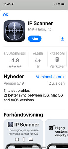

Anyone know what id the pump could be showing in under clients in my router?
I have so many entries that it is impossible to figure out which one it is so I can make it static and get it added in Homey.

Yes, I am trying to find it’s connection in the list of clients connected in my router so I can set it static or have I misunderstood, and just need to enter my ISP IP?
If it’s the pumps IP, I am trying to figure out what the name of it would be as I have a long list of connected clients in my router with all sorts of names and I assume it’s not as simple as if I was looking for an IPhone as that does say IPhone.
So what I need help with is what others have found it listed as in their connected clients in their router.

@Michael_von_Barner - I think @Soren_Mogensen is asking how to find out the IP address of his device on the local network.
Does anyone has a good tip?
@Soren_Mogensen I use this IP scanner when it is on wifi on my IPhone

@Soren_Mogensen Sadly its a game of deduction as - atleast in my case - the heat pump does not report any name, brand or similar to ip scanners and router tables. You can rule out anything with brand name, or any other info. Depending on your router it may be more likely with a higher ip number if you recently connected the pump to wifi first time.
After this - trial and error. Good luck!
