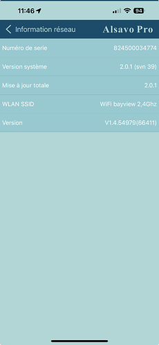

I can’t seem to get it to connect in Homey, just keeps connecting, but I am also not sure what the serialnumber should look like, only thing I can find on the pump is a long string with A after?
Do I have to enter the local IP it has when trying to addit in Homey?
Thanks in advance!
Alaska I serial can be found on Alsavo app: just click on Alsavo pro on top right of the layout
