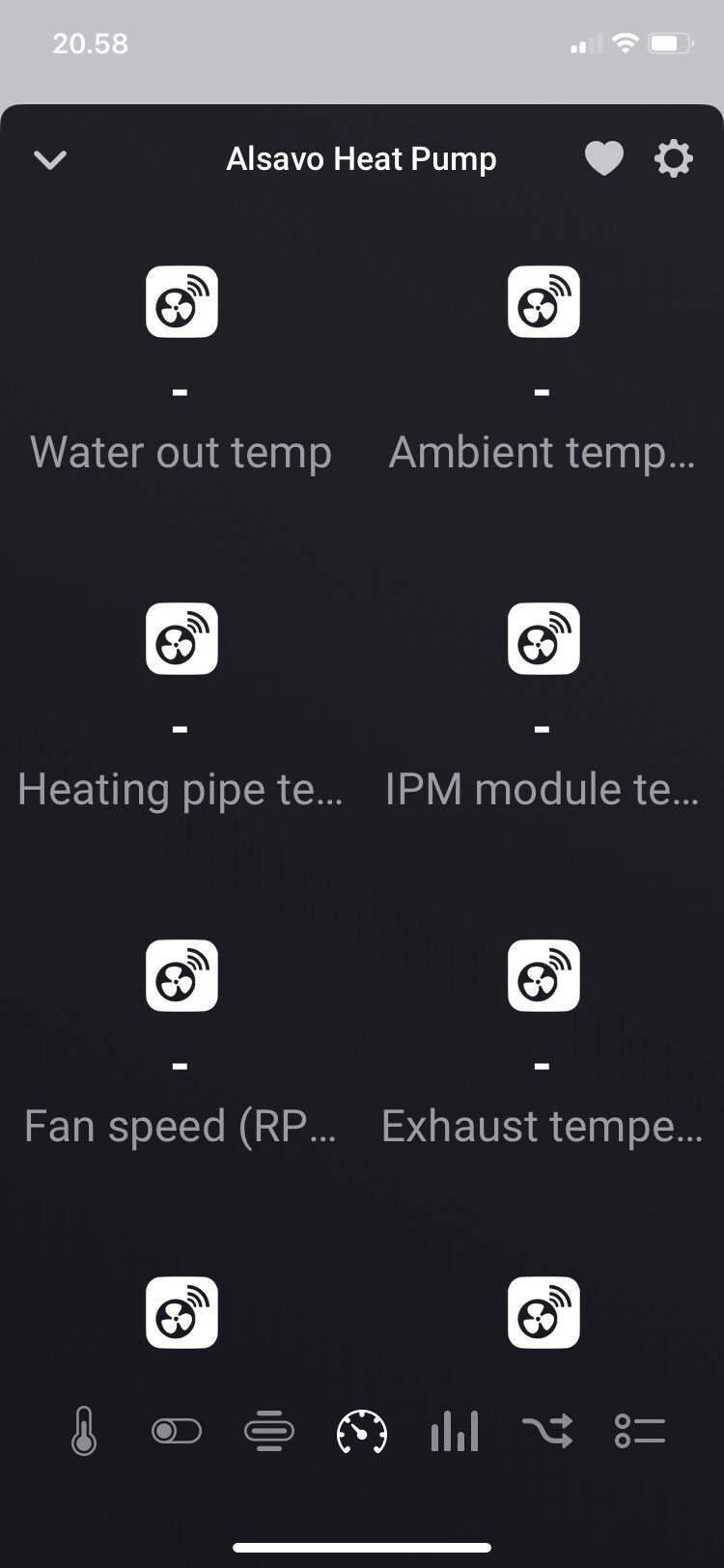

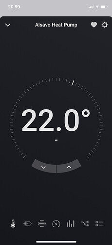

I have now restarted Homey app, and there are still no contacts to the heating pump.
I have try to send a diagnosis report and got this message in Homey: “send this code to developer: 757a6686-5d80-43d9-9275-77b46822e76b
As you can see on the 2 screen photos, there no connection to heating pump.

I have restarted both Homey and the heat pump. If I switch off wifi, I cannot get in touch with the heat pump in the Alsavo app. if I switch on wifi I can contact the heat pump in the Alsavo app but not through Homey.
