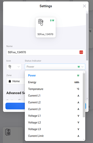

Hi, is it possible to add to the status indicator:
the specific powering setting:
so that in the top right I can immediately see if the unit is in the right status? Always want to maximize the car charging from the solar power
Don’t think that is possible. The status indicators are all automatically generated. Don’t think I can make something to show it there.
Oke clear, then I might need to make a separate advanced device icon.

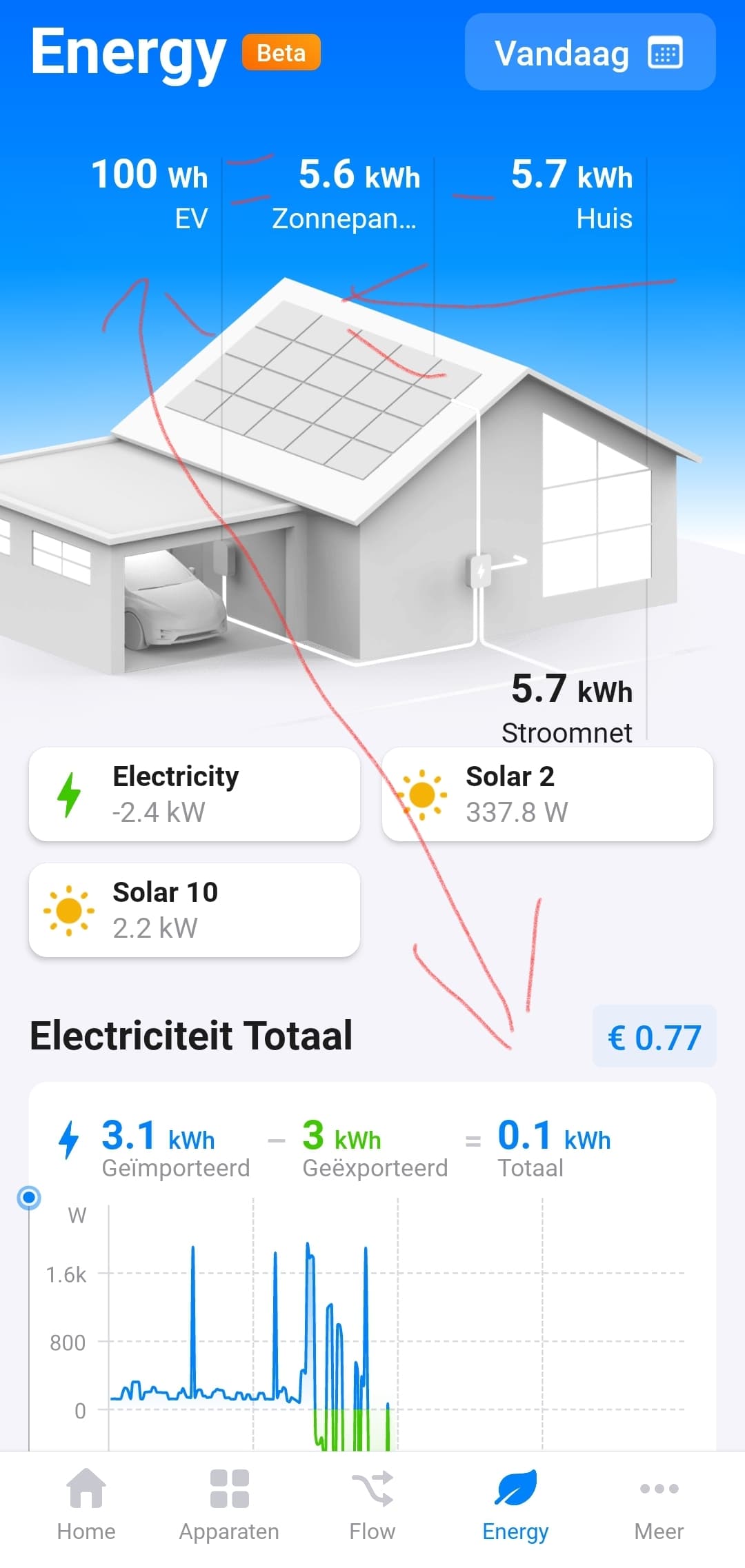

Is it somehow possible to add the charger in the energy dash?
Isn’t that supposed to be the ev value?
no it is not. that is the total usage of the energy supplier. it is the sum of own consumption - solar power from solar panels.
Okay, that doesn’t seem very logical to me, as I would expect the sum to be shown in “stroomnet” (under the animation). Also, you would expect “EV” to stand for “Electric Vehicle,” especially since the graph includes an illustration of an EV with an animation showing power flowing to and from it (V2X).

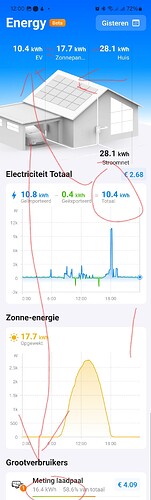

I understand what you mean! But look at this picture:
And look at this picture from yesterday:
Yes, I know this is how it is shown currently, but hope that is a bug.
