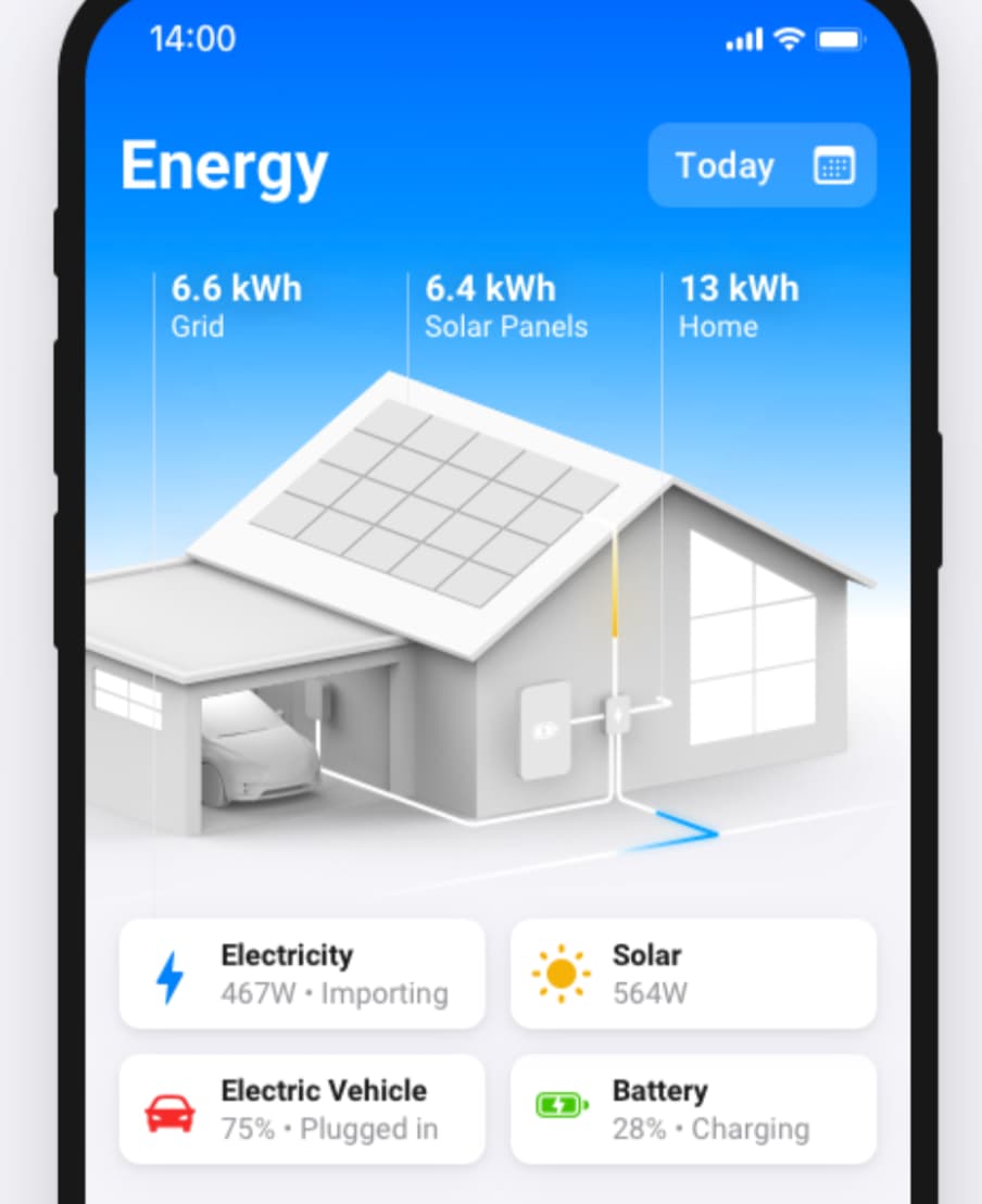

In the promotional screenshot of Homey energy they have an Electric Vehicle button. Does anyone have this working? And if so how? :slight_smile: :grinning_face:
Not working here. I alsof want to know how to do this.
Just turn on phaseshifting in the my eve app and thats it
