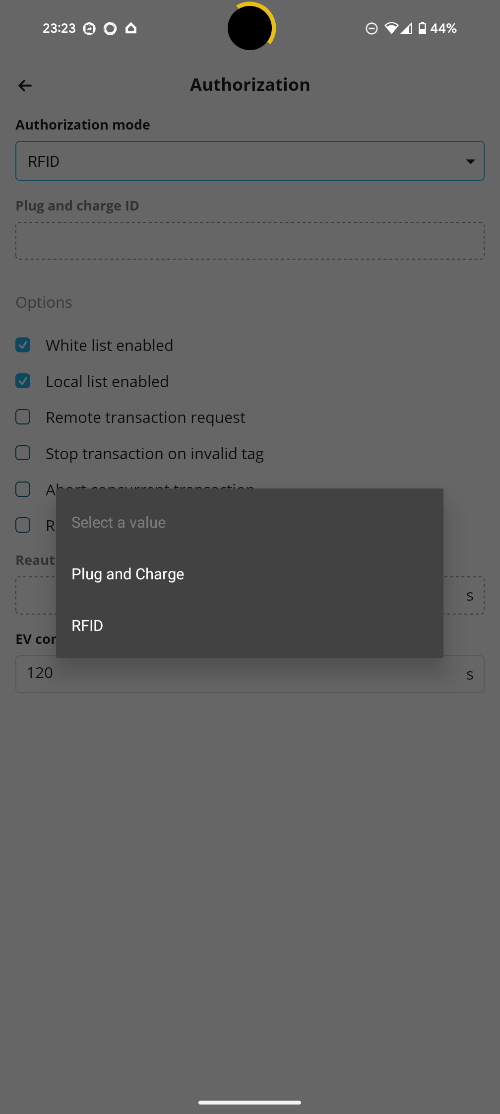

This setting can be reached by:
Advanced (top middle tab)
Autorisatie (authorisation) menu
Autorisatie option
There are serveral things which can be changed, one of them being Autorisatiemodus (authorisation mode).
I see 2 options:
  1. Plug-and-charger
  2. RFID
I don’t see a third option.
Found it. Had the eve connect app iso the my eve. Thanks for the pointer.
For me same only the two options
Thanks! Those are the two options supported by the Homey app as well. So don’t know what went wrong in your case. Tested it with my charger and seems to work fine (if you don’t fire to much commands and don’t have any other Alfen app open on another device).

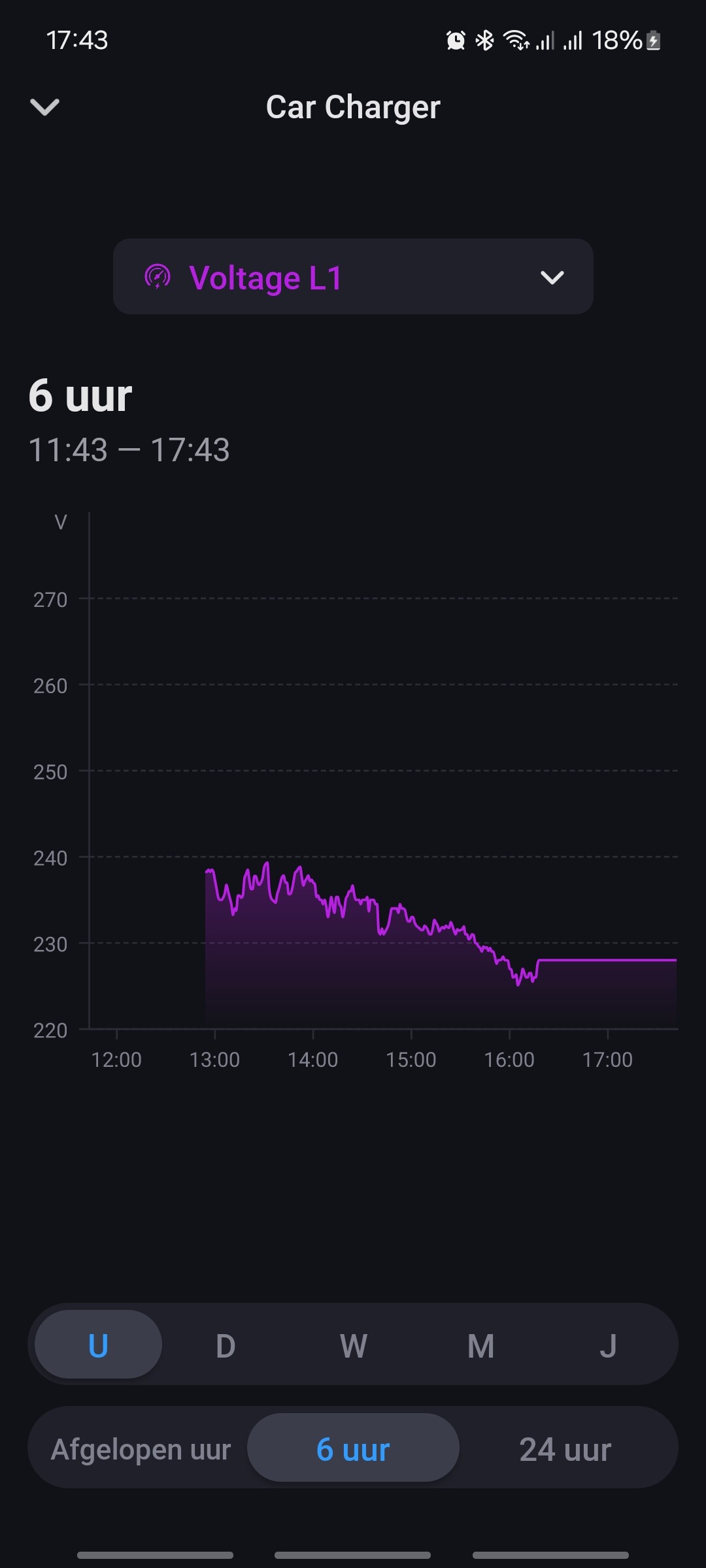

After a certain time nothing is updated and adjusting the charging mode is also not possible. sometimes after an hour and sometimes after a few hours. a red popup will then appear very briefly. it’s gone too quickly to read. I now restart the app every half hour. and then it works fine.
Sounds like a work around :see_no_evil:
Can you send a diagnostics report directly after restart of the app? And then another after a minute and then another after around 28 minutes?
Athom truncates the diagnostics reports, so if I have a couple I hope to find something in there that can indicate why it is not working properly on your homey.

Problem still there. I’ll try to make reports tomorrow. In this picture you can see that the app stops reporting
