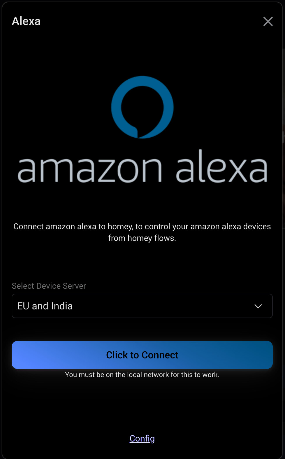

Mine has stopped working it doesn’t allow me to connect to alexa server thru eu and india. I have disabled alexa skill and reinstalled alexa on homey pro and nothing is working. I have tried it on windows and andriod all no luck. It was working and suddenly it has stopped. Can you help me please :folded_hands:
Had the same problem really annoying as it was a few weeks ago and I have updated homey pro and now it doesn’t work

Homey will not connect to Alexa until the Update at last night - Error ist not defined - please fix it

Your app was sawesome until… Homey doesn’t connect to my Alexa account anymore ! :sob:
A pop up window show the following message : Error is not defined. Can you please take a look to fix it ? I’ve send a report about that : 8c7b3890-1556-444c-b5be-4a8e04bf5aae

and now when i have reinstalled it and try to add a device or go through setting and try to configure. It Says Error not defined, Could someone please help me?

I had a chance to load up the app, turns out it was actually a fairly minor issue - the way amazon was notifying had changed in some circumstances.
Should all be fixed: Alexa | Homey
Im pretty confident, so ill push it out to everyone as soon as a couple of people verify that its now working
