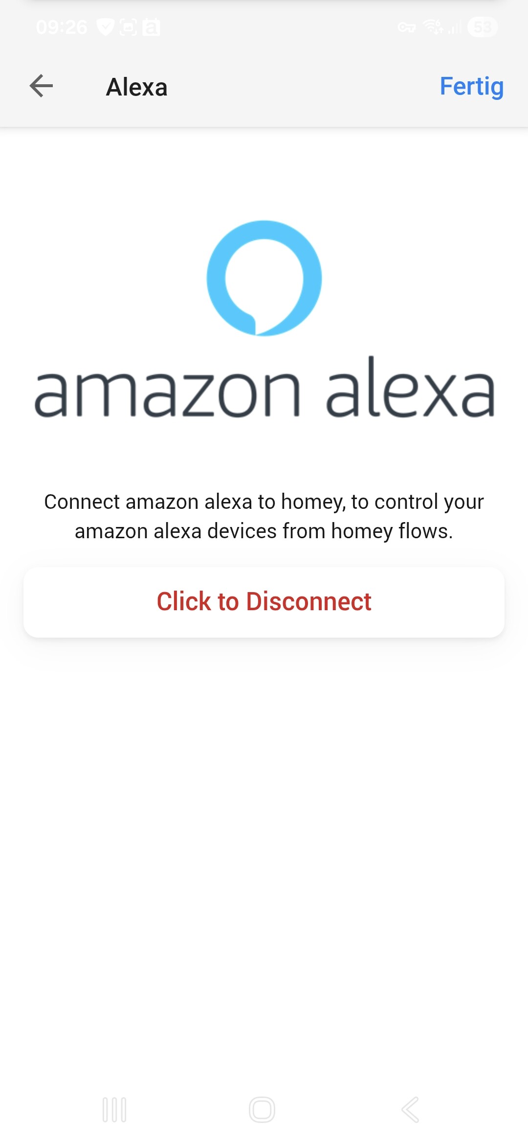

I can not get past this page. Everything is on the same Wi-Fi network.
Hmm, that looks like the repair screen, ill check it out tomorrow in the mean time reconnect from settings → app → app settings, it should work.
