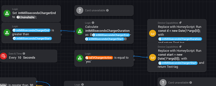

I just imported this flow
But somehow, the variables don’t get presented as variable everywhere, but their ID is shown instead. The variables were created fine by your script
Here’s a Var ID check, it returns a just created variable, used in the flow
Okay, ill fix this.
Because looking at you picture, it show that the reference ends with ]] but the dont open with [[, so somewhere i have made a replacement error.

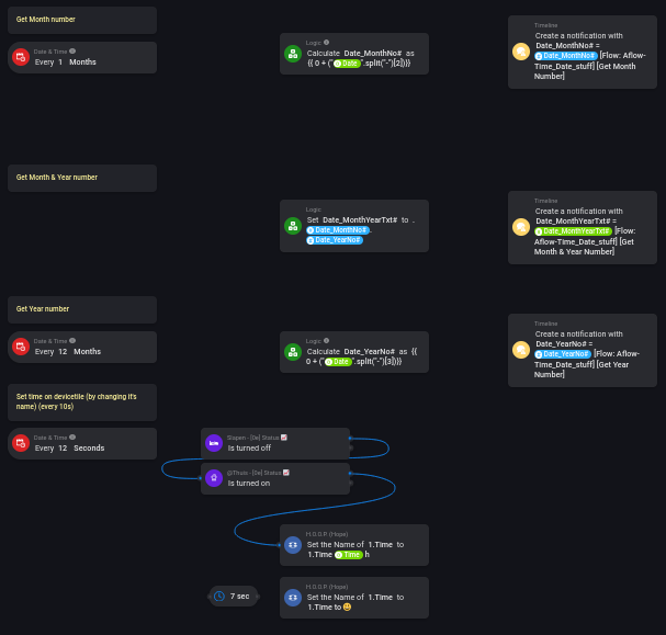

Hi Peter,
Is there any way to get rid of that leading 0? Show if I want to show the time in the tile, it will only show the time like: 22:15
Instead of: 0 22:15
In the Web App, yes you can replace it with a Dash (-) by using the Set Status Card with Number and leave number empty.
But it will then show nothing in the Mobile App.
Athom (might) be working on it, i have had contact about the difference in Web en Mobile App en asked that, since the need to straigten the difference out, the nicest thing for users would be that units wil be displayed with an empty value if the value is empty.
And it could be done, because there normally are no apps that leave the capability value empty. Athom didn’t even know about the difference between Mobile and Web when a device capability value is empty.
But we will have to wait and see.
As a developer, i cannot do anything about how the numbers + units is displayed. Only Athom has the ring of Power for that! :wink:

hey @Peter_Kawa , in the version is just pushed to Live, the variable creation is completly fixed as far as i know: droptokens didn’t get linked correct after creation.
This is now solved.
The EV Charger Status Device Tile - AVD Template import correct now (if you don’t have the variables allready).
Still an issue when finding existsing variables i see, fixing it now.
Fixed in allready currrent live version!
Here i import a Flow from someone else, but with the same variable names as i allready have got (because i allready imported the flow).
Now there will not be an error, but it will replace the variables in the flow with yours (that is, the same name, but other IDs)
It looks better indeed, Arie.
But now I’m missing ‘wires’ somehow, but not all are missing.
Create it with the latest file please.
I think you have created this file with the Live version that had a bug.
It does not in the newest live version.
The bug was in Export, when creating a file.
The bug was live about 10 minutes, 30 people did get the install with the bug tho.
Version 2.6.50
Wires are okay again, but the ]] thing is back :wink:
Not in 2.6.52.
