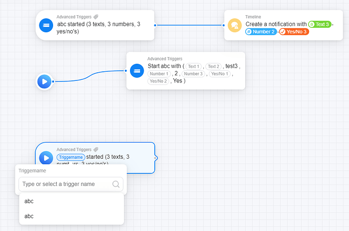

The trigger-names are collected from the when + then card. Which leads to duplicate entries in the browser:
Actually, the Whencard shows the list of the names used in the Thencards, and Vice Versa.
But it also shows, at the top of the list, the last typed name.
But the duplication has been fixed in version 1.1.2 which is in test right now:
Advanced Triggers - Test | Homey
Everything works fine now!

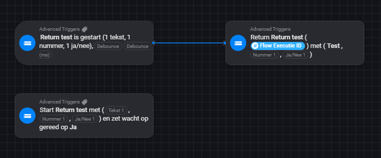

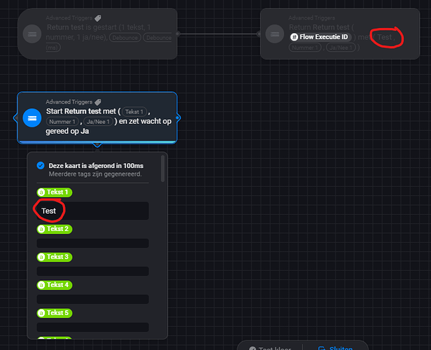

Update coming up:
  • Start [[trigger]] now has the option
    • To wait for the executed flow to be complete (it always did this allready)
    • To not wait for it to finish
  • When waiting for it to finish, you can return values.
    This way, it can functions like a real method.
